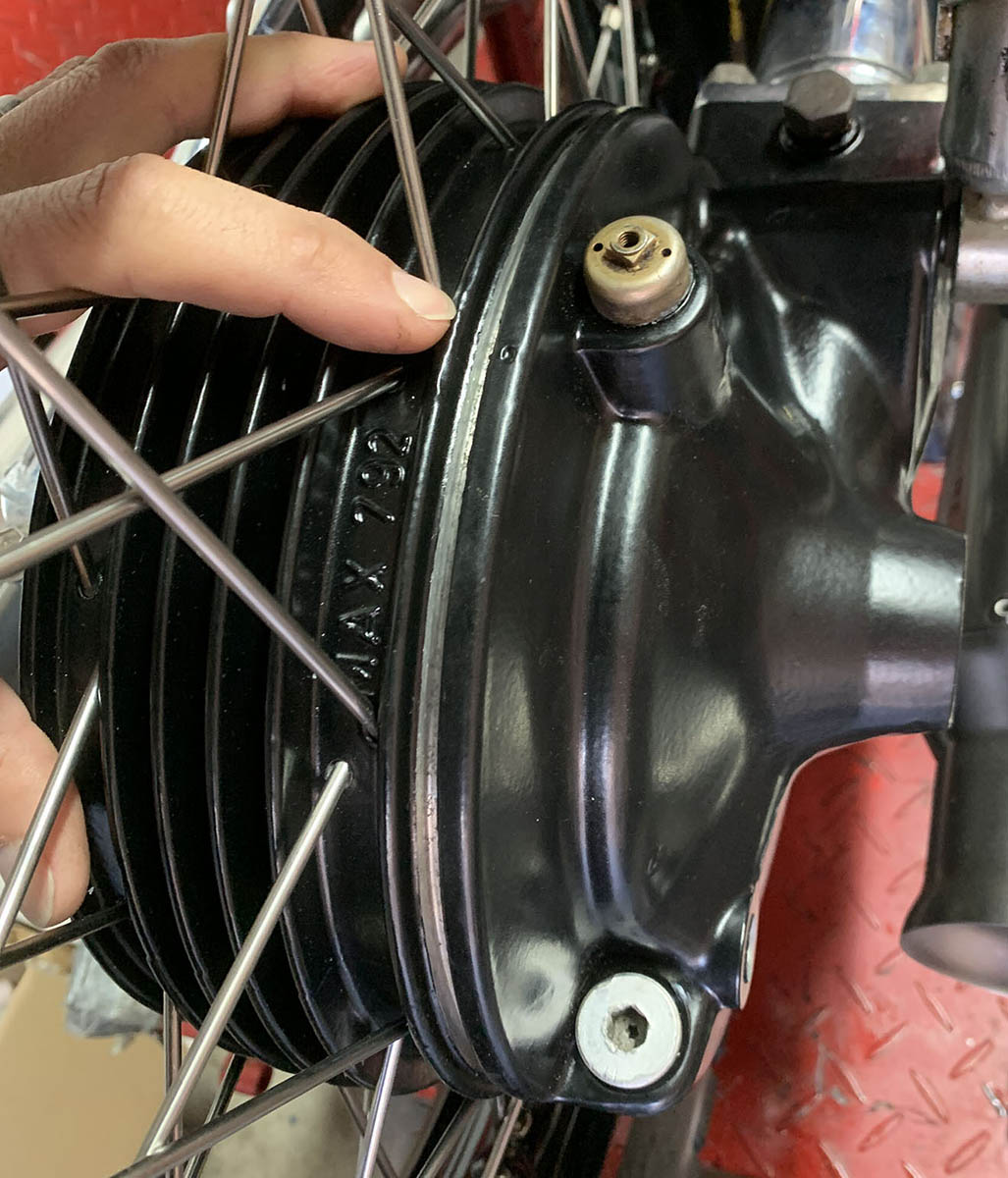

I'm assembling a /5 at the moment and hit a head scratcher.
The final drive has been apart and re-sealed / new gaskets. Turns as expected. Same splines (they were in good shape), same shims.
The wheel hubs have a 69 stamp on them.
I'm getting a big gap (maybe 1/8 inch) between the hub and the final drive housing. I'm not sure if it is due to the wheel bearing spacer, or the splines, or the new seal by the splines not allowing the hub to fit all the way into the final drive..?
I've tried the wheel on other '76 era spare final drives and it fits OK.
I've tried spare hubs (with no bearing spacer) and it fits *maybe* slightly better than the photo.
I know there were different spline lengths on either the wheels or the hubs back then, until they went with longer splines in the mid 70's.
Has anybody seen this issue before?
Ideas?
TIA
-JJ

Long story but the bike was a basket case and I'm using a different /5 hub that what came with the rolling chassis.
The bad part is that it is an early /5 hub where you have to put the top hat spacer in with the stack, and it takes the aluminum seal with felt behind it. (Vs the later hubs where you could remove the top hat and seal.- I'll send photos if you are unaware of the hub differences.)
I torqued the axle up to 25 foot lbs and the gap went to 'normal'. So that's a good thing.
However, the wheel was somewhat hard to turn at that point.
When I loosened the axle torque, the wheel spun as expected.
So I probably have an issue with the Final Drive.
My conclusions are based on this:
#1 - The final drive was re-sealed. Same shims and bearings were used as original. I have a suspicious feeling that the seal around the splines has too much if an ID and the driving dog makes contact with that seal, creating the stiffness.
The same issue occurs with two different wheels/hubs.
#2 - The bearings were replaced in the hub. Perhaps the stack is too tight and when torqued. However, I put an axle in with no Final Drive, torque it (using a large spacer), it spins with minimal resistance (probably due to grease).
Luckily the brake shoes are not in yet as I'm test fitting before other parts go to powder coat. I think I'll need to remove that inside Final Drive cover and inspect/replace the seal around the splines. The seal I used was from Motobins and was probably not OEM.
Unless you guys have any other ideas??

I figured it out. The seal around the splines was too far forward, towards the end of the splines.
It was almost covering the entire drain hole. I took the cover off, pushed the seal back towards the bearing more, put the drive back together, mounted the wheel, torqued the axle and everything spins as expected, and the hub fits in the FD as expected. My only worry is that moving the seal around may have compromised it somehow. At least it is one of the easier ones to replace should it need it.
