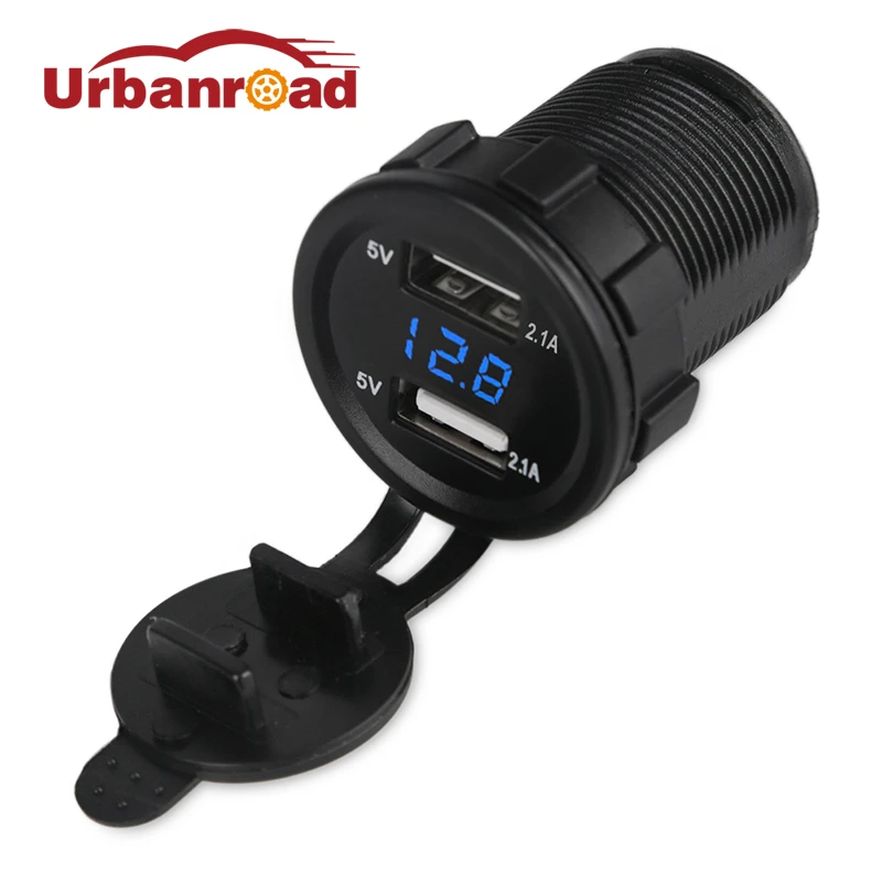

I'm contemplating something like this for Edgar:
I was primarily looking for dual USB and I found out that they can be had with a volt reading. I'd mount it on the dashboard of the Luftmeister.
The fairing has some always-on running lights and I'd probably take the feed from them. There's probably some voltage drop as compared to what the battery sees, but there would be no draw when the ignition and lights are off.

The issue with a voltmeter (any voltmeter) is that it only 'sees' the voltage at it's input terminals. Unless the input terminals are connected direct to the battery, the voltage reading will be affected by the load carried by the wiring (including the ground) and the resistance of all of those wires. In essence, the voltage you're seeing is not what you want to see (i.e. voltage at the battery terminals) but that voltage less any voltage required to push the required current for all of the circuits shared by the voltmeter.
In practice, provided you're not looking at the voltmeter reading as an empiric reading (i.e. exact), it isn't too much of an issue. If you use the meter as a comparative indicator (i.e. the reading is what you would expect to see under the current circumstances), then all is fine... if the reading is significantly different, then it's time to start checking things.
If you want an accurate reading (within the limits of the instrument), then there's really no alternative but to wire the meter back to the battery terminals. This, of course, means that meter will be permanently 'on' unless you arrange a relay or switch to disable it when the bike is off.

This is what I've done with my /7 with Luftmeister voltmeter. I run the power through an aircraft quality switch which goes through a hole in the interior panel of the fairing. Thus, essentially no losses to the meter.Rob Frankham wrote: ↑Mon Sep 27, 2021 4:06 amIf you want an accurate reading (within the limits of the instrument), then there's really no alternative but to wire the meter back to the battery terminals. This, of course, means that meter will be permanently 'on' unless you arrange a relay or switch to disable it when the bike is off.

Before you buy one of the USB and volt meter setups. Check to make sure that it shows battery voltage when using the USB. Some switch to showing the USB voltage while charging.
All, I have thought about using a relay on a volt meter. My question is how much of a loss is there with the relay?

That's a 'How long is a piece of string' question. If you use an automotive relay and the contacts are good, the voltage drop will be negligible, especially as the current used by the voltmeter itself is very small. If you want to go better, an industrial relay used in electronic circuitry will have better quality contacts... if you really want to get serious about it, then a mercury wetted relay wouod be the way to go... but... all of this is a bit academic in the real world since even a cheap automotive relay will have a lower contact resistance than a the accumuated connectors in the circuit and certainly less effect on accuracy than the accuracy of the average automotive voltmeter.Tom H Ca wrote: ↑Mon Sep 27, 2021 12:07 pm Melville,

Rob, thank you for the info. I thought it would be so little that it wouldn't matter. Just wanted to make sure.
