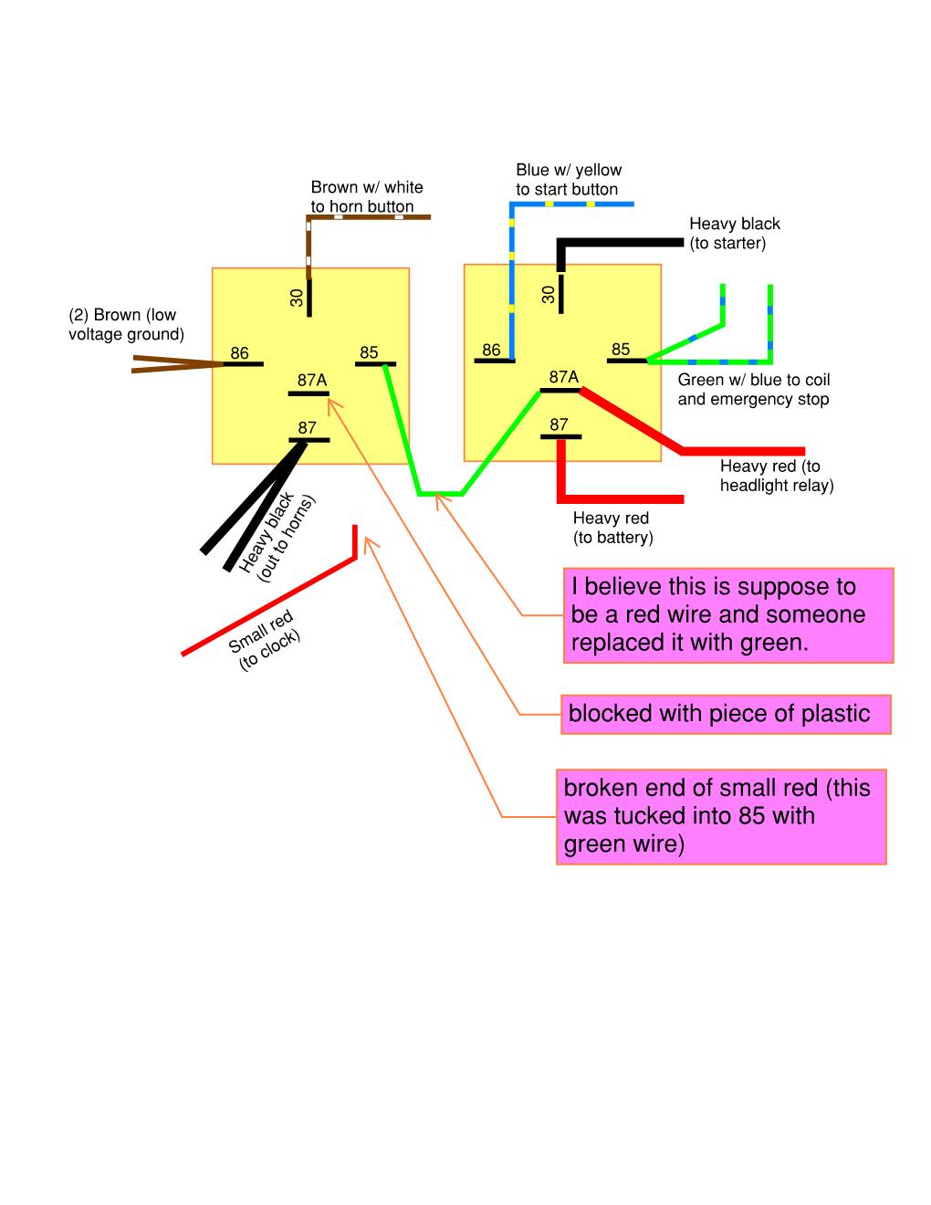

I got a new relay finally and now believe someone had it wired up incorrectly. I diagramed what I have so I could compare it to the wiring harness in the clymer manual. Everything on the starter relay makes sense and looks right (except the green wire which is supposed to be red), but I think someone replaced it with a green wire to tie to the horn relay and maybe mixed up the terminals when they did. I think I just have to figure out how to de-pin the brown and green wires and swap them so the green goes to 30 and the brown with white goes to 85 (though as the starter relay goes to ground through 30, maybe that is where the black wires to the horns should be and the green should go to 87...hmmm).
If anyone is familiar with these, can you confirm that:
A) The horn relay should be 4 pin (the socket for 87A on that terminal appears to be blocked with a solid piece of plastic)
B) the brown with white goes into 85
C) the red wire to the clock should connect to wherever I put green (though I may replace with a correct red).

A light dawns...6bikegarage wrote: ↑Tue Dec 30, 2025 8:16 pm I got a new relay finally and now believe someone had it wired up incorrectly. I diagramed what I have so I could compare it to the wiring harness in the clymer manual. Everything on the starter relay makes sense and looks right (except the green wire which is supposed to be red), but I think someone replaced it with a green wire to tie to the horn relay and maybe mixed up the terminals when they did. I think I just have to figure out how to de-pin the brown and green wires and swap them so the green goes to 30 and the brown with white goes to 85 (though as the starter relay goes to ground through 30, maybe that is where the black wires to the horns should be and the green should go to 87...hmmm).

Assuming the terminal names you show in your image are from the relays themselves, you have the wrong starter relay. The fifth terminal on the starter relay should be marked 87, not 87a. BMW themselves made the mistake in their original wiring diagrams which were copied by Haynes and the only reason that Clymer can claim to be right is that they don't show terminal designations at all.
The correct relay, as I say, should have two terminals marked 87. These are permanently connected together inside the case. The power to activate the relay itself, goes through these connections so nothing on the bike will work with that relay in place.
You may be inclined to desregards this, after all, BMW made the bike so, of course, they got it right... all I can say is even if you don't believe it, check it out. If you follow the wiring diagram, you'll find that, all of a sudden it makes sense... of a kind.
The full story (or as much of it as I know) is...
For some reason, lost in the depths of time (well, at least I don't know what it is), when BMW upgraded the wiring for the /6 series, they decided to route all of the power for the whole bike through the starter relay. For some reason they wanted the two red wires (one from the battery and the other to the ignition switch) to be connected to seperate terminals at the relay with the terminals permanently connected together. They also found that a suitable standard relay was available if they ignored the DIN standards for terminal identification. which state that terminal 30 should be the contact power connection and that 87 (87a, 87b) should be connections out to the controlled circuit(s).
The simplest way to check if this solves your problem is to remove the wires from the 87a terminal and connect them temporarily to the wires connected to the 87 terminal. If there are no other issues, the bike should spring into life... In fact if you chose to make that arrangement permanent, you would simply be upgraging the system to approximate that used on the early R45/R65 models.
