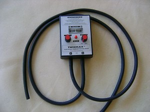

Twinmax.

The Twinmax got my attention, but the price cooled it back down. Pushing $100 from what I saw. It's not just the money. It's also having to admit (if only to myself) incompetence in tuning airhead carbs by ear.

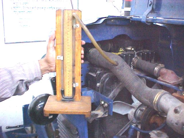

Using a manometer is an intriguing idea, since I have a couple. How did you make an access to a vacuum port, did you modify the boot between the carb and head???

Hello Jagarra,
Many Bings have a port right under the butterfly and close to the idle mixture screw. This brass port is sealed by a screw.
Older one have the port near the butterfly pivot. Sealed by a screw also IRC.

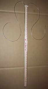

One of the most precise and easy to make manometer involve buying a board around 1m20 long, crystal plastic tubing and jumpers used to attach electrical cables on a panel.
Put the tube on the wood panel, making a U and attach it to the wood. Pour colored liquid in the tubing (I use permanent anti-freeze for cars which is a red fluorescent liquid) and plug the two tube's end onto the carbs vacuum ports.
Imbalance is easy to see because the two liquid columns will reach different height on the panel. Perfect balance is also easy to spot as the two columns are very close to each other.
If you're rich, Motion Pro sell carb synchronizer based on this principle, filled with mercury but for four cylinders engines. Mercury has the advantage of making the instrument more compact as the density of the "liquid" is greater than the one of the anti-freeze.
Anti freeze is safe if swallowed by a small amount by the engine.... If the engine swallow it, your board is not long enough.

I put it on the bike and gave it a whirl, it seems to be easy to use and I think that it works properly. The gauge mode gives you the possibility of seeing the numbers, comparing the pull of one cylinder against the other, which is easier to get to than with mercury gauges. Seeing the free play on the throttle cables seems to be a bit easier than with my 1984 set of mercury filled gauges.
Other advantages might be the ability to stap the Harmoniser onto the tank bag and see what happens in the real world, it also has a tacho function and an LED light for reading in your tent at night!

I have both a TwinMax and a Carbtune.
The great advantage of the TwinMax is its ability to be used while riding the bike. On something extremely sensitive to balance (like R1100's) this is a very nice feature. That might be of some use in racing, as well.
The Carbtune has many advantages: it shows an actual measurement in cm of mercury (the Twinmax only shows a comparative non-quantified measurement) so it is a useful vacuum gauge for more than just balancing carbs, no batteries to die or leak, it's really sturdy, it has no liquid, it can't get out of adjustment (as gauges do with time), and you can use it on bikes with up to 4 cylinders. Because of the weakness of the Pound, it's even pretty affordable right now. Because of that, I think it's the best way to go for most people (if you want something better than the homemade jobs). If you want to just do it by ear, then you don't need any of this stuff.
If I ever get rid of my Oilhead, I'll also get rid of the TwinMax. The Carbtune is a tool I'll keep for life.
Edit: the Harmonizer looks to be a MUCH smarter replacement for a TwinMax. I think I would choose it over a TwinMax today, but almost all the advantages of the Carbtune still apply when compared to the Harmonizer except that the Harmonizer can also give an actual quantitative measurement - albeit only when measuring a single source, not while balancing two. If the Harmonizer comes out in a 4 cylinder model, choosing between it and a Carbtune would be a matter of taste: higher precision and more information vs. virtually indestructible simplicity.
