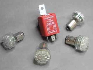

If you really want LED directionals, you’re better off looking at replacing the flasher with one made for low draw bulbs similar to this:
http://www.motoelekt.com/ledKit.jpg
http://www.motoelekt.com/lighting.htm
If you are looking to save power, putting resistors in the directionals that burn off electricity as heat seems to not gain anything.
The headlight and tail light are better candidates.

1) We don't know what the current consumption of the LED indicator in this case. The Motoelekt relay is designed to work with specific LED bulbs so we don't know whether it will work in this case.
2) The Motoelekt unit is designed to work with LED bulbs all round. You can't use it with LED at the front and filament bulbs at the rear.
Done properly, the 'resistor' route will means you can use just about any combination of bulbs and LEDs provided you pick the apporopriate resistance value resistor.
