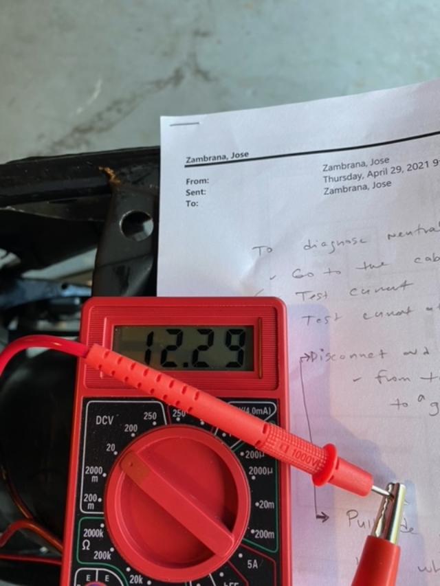

But based upon the second youtube video above, even if the diode is bad, the clutch switch should provide the a ground and allow the starter to spin, so I don't believe the diode is the issue. On the '75, and I believe the '83 as well, the clutch switch wires go into the headlight shell. One wire provides power in and the other goes to ground (brown). [b]The wires from the clutch switch connects to a plug that is exposed in the down side of the triple tree. [/b] See photo. From there, it goes into the harness that goes below the tank.
Verify you have a good ground, and that the other wire has good power. If you pull the ground wire off, verify you get 12v at that wire every time you pull the clutch and 0v when you release it. If you do, it's probably a ground problem. If you don't, then verify the power source the other wire is connected to in the fuse block.

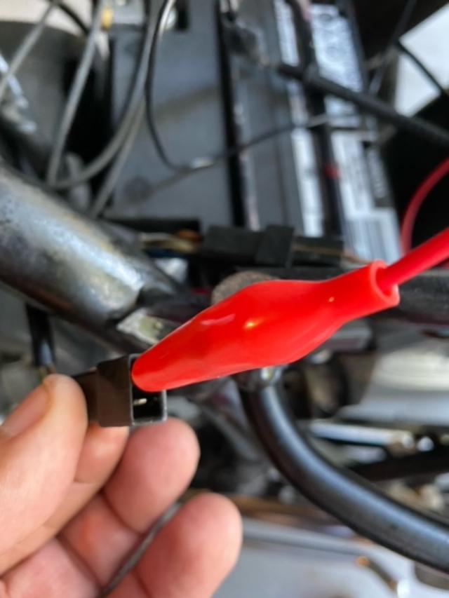

I then went to the plug that is located on the left side of the bike, behind the side cover and by the battery. This plug connects the cables from the main harness to the neutral switch and to the oil pressure switch. I unplugged it and tested for current and it has 12.26 volts in both terminals (the brown/green and the brown/black). This did not change when I pulled the clutch lever in. I cleaned the plug to eliminate a bad connection.
I then went to the neutral switch and was able to touch the two terminals to test continuity. Weird thing is that it showed continuity of 0.00 in Neutral and .003 when in gear. Is this normal?
I did not take the tank out so I didn't test the diode. I will do this in the weekend after I have a bit more feedback.

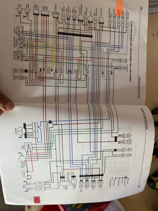

Here it is.
- BMW Wiring Diagram.jpg (74.77 KiB) Viewed 1296 times

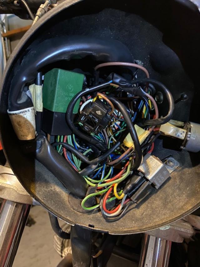

Ok. I have the test light and remove the headlight. It looks scary all the stuff packed there. See photo. Connector box with the two fuses is all the way back. What I should looking for?
