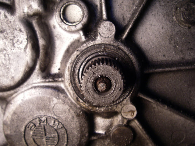

Once the transmission is out, it is quick and fast to check the end play. Why wouldn't someone do it? It is a check that doesn't require the cover to come off.

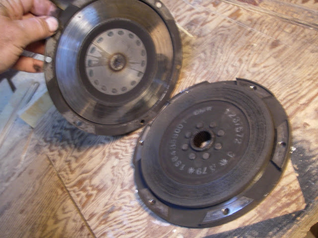

Please Tell Me What You See
Posted: Tue Dec 14, 2010 5:28 pm
by bbelk

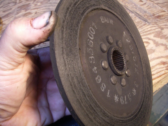

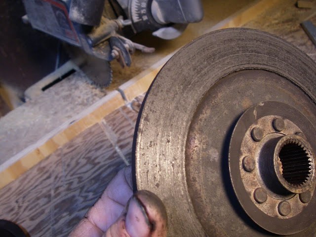

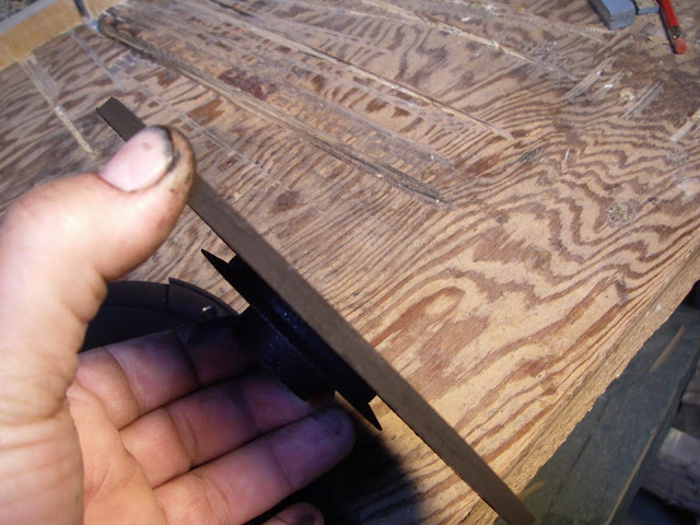

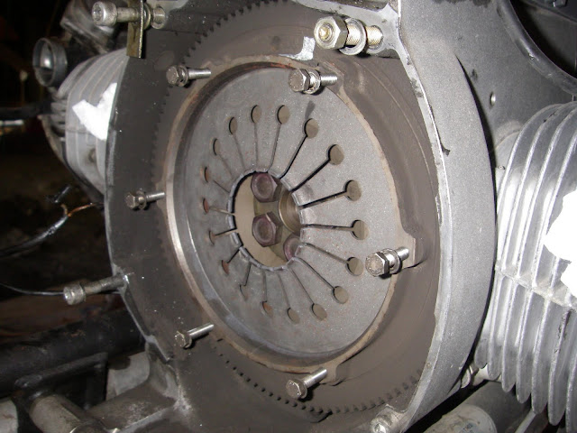

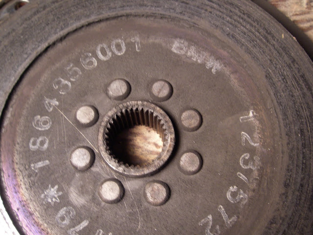

I have not found an obvious cause for my jerky clutch. Nor have I found a reason for it to slip. There was a fair amount of dust in there. There was no detectable end play in the transmission shaft.
Re: Clutch issue
Posted: Tue Dec 14, 2010 5:50 pm
by robtg
Too much grease on the splines ended up on the disk.
Re: Clutch issue
Posted: Tue Dec 14, 2010 6:02 pm
by Airbear
What does the other side of the pressure plate look like - the bit where the 'teeth' of the diaphragm spring engages? Have you measured the height of the diaphragm spring? On mine the teeth had dug holes in the pressure plate and provided a very plausible cause for my jerky clutch action - since fixed by replacing both parts.
Re: Clutch issue
Posted: Tue Dec 14, 2010 7:44 pm
by mattcfish
Your second picture shows grease spinning out onto the pressure plate and disk. Is that gear oil from the tranny or is it just spline lube?
