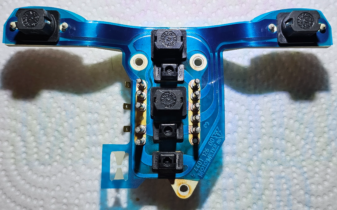

I have dismantled the dash again for further investigation. There was a burnt dim light that needed replacing anyway.
Armed with a tester with a probe, I thought maybe I could have the lights to light one by one.
Screenshot from 2025-10-20 18-52-47.png (1.41 MiB) Viewed 11399 times
Call me dumb, but I should be able to light the charge bulb as well, shouldn't I?
I managed to light all of them but this one. Is there something I'm missing?

You might have a break in the copper foil that is part of the circuit. Might want to consider opting for the Kat Dash replacement:

Check the contact surface between the bulb holder and printed circuit.

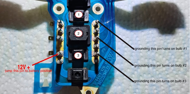

Alright, so it happens that taking good pictures helps.
By zooming on the previous one, I managed to get that the pins involved for the gen bulb are (starting from the bottom) the second one on the left, and the third one on the right.
After a second cleaning, I placed the bulb and holder back in and it lit.
Let's have a test on the bike now.

gspd wrote: Mon Oct 20, 2025 1:28 pm Check the contact surface between the bulb holder and printed circuit.
Yeah! This is what I figured.
Thanks a lot for this as this confirms that this is working as it should now.

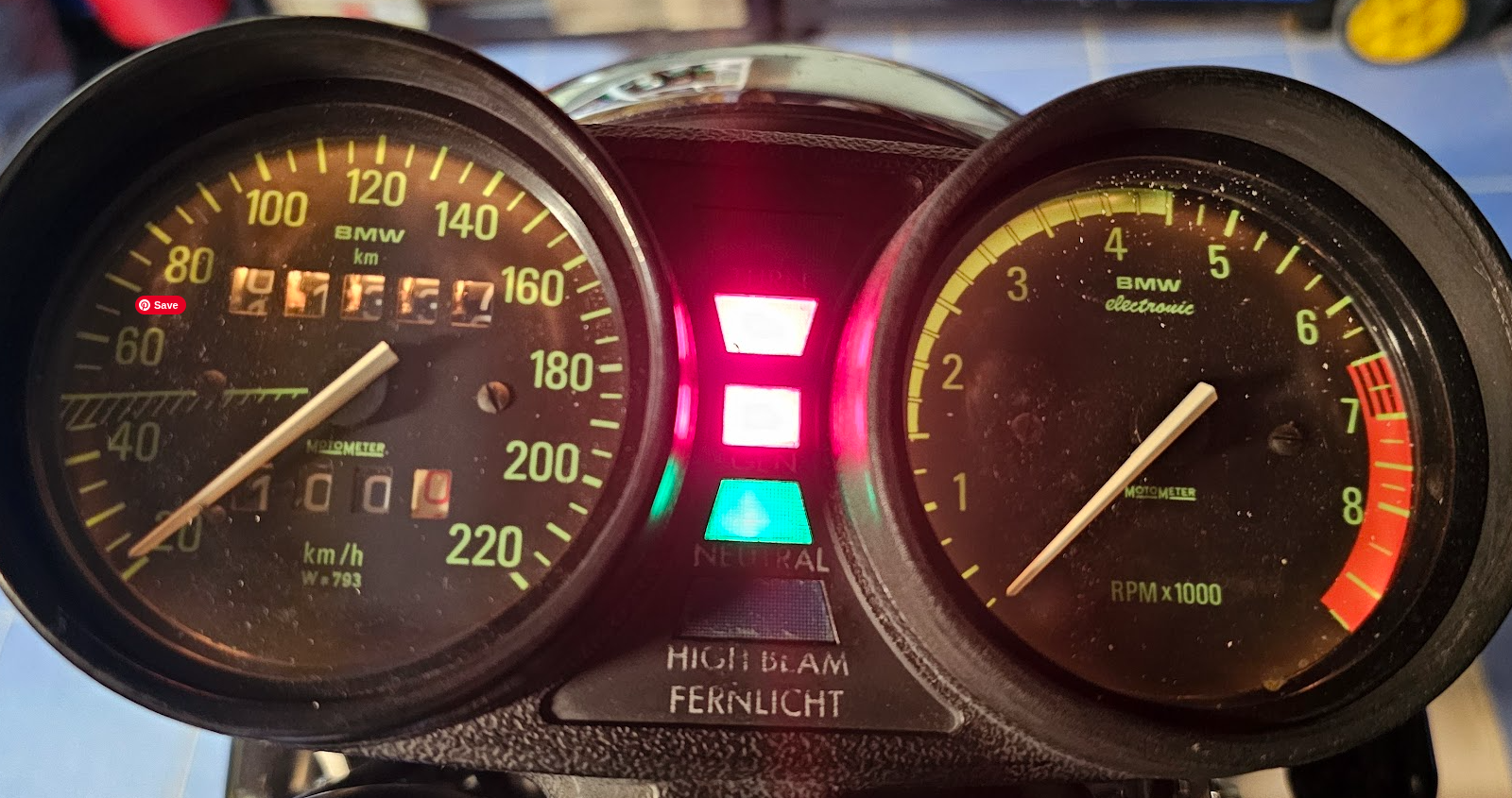

Couldn't wait, I had to test it and look what I got!
Screenshot from 2025-10-20 20-44-38.png (1.87 MiB) Viewed 11375 times
That's a good sign. A first one. I'm still going to do the continuity test you suggest, but maybe a lit on bulb does it for the continuity.
Alright I may still have a charging issue, but I can't go any further today. Stay tuned, I might come back with some more annoying questions.

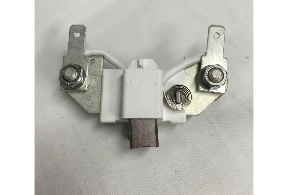

Just a tip. As shown in your first pic, your brush tension spring is too 'loose'. You should wind it a full turn tighter. Remove the stator and check the inside one also.
Although it sounds counterintuitive, the brushes last longer and perform better with more pressure on them.
Both springs should be tightly wound, like this:
