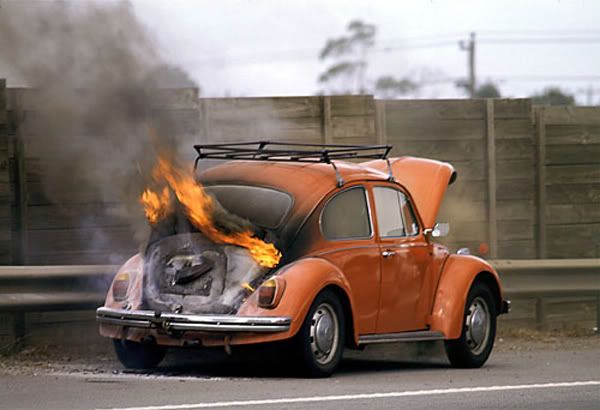

Tim Shepherd wrote:...I just picked up a '67 Bug myself...
SWEET RIDE !
just one thing ...
don't let this:
turn into this:
BEWARE ! FIRE HAZARD !
Get that fuel filter away from the dizzy !
And right out of the engine compartment – where it belongs !

And while we're rebuilding this thread:
Don't forget clamps on at least the bits downstream of the pump. Consider the application of safety wire on the pump outlet and carb inlet as well. Those are straight presses and if they let go, electrical bits get sprayed :shock:
My cousins were motoring one day with their parents when they had one burn BITD. My cousin said "About ten minutes going from back to front and then BOOM."

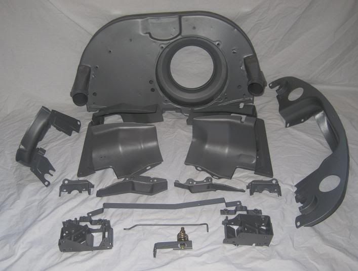

... all the tin in place and all the hoses and wires in good shape.
Just received the tin set that I ordered from Volkaholic.
I did not need a complete set,
but ordered the bits that I wanted / needed to produce cabin heat in the bug this winter.
All OE VW pieces powder-coated in "Satin Grey" by Volkaholic.
Excellent work IMO:
