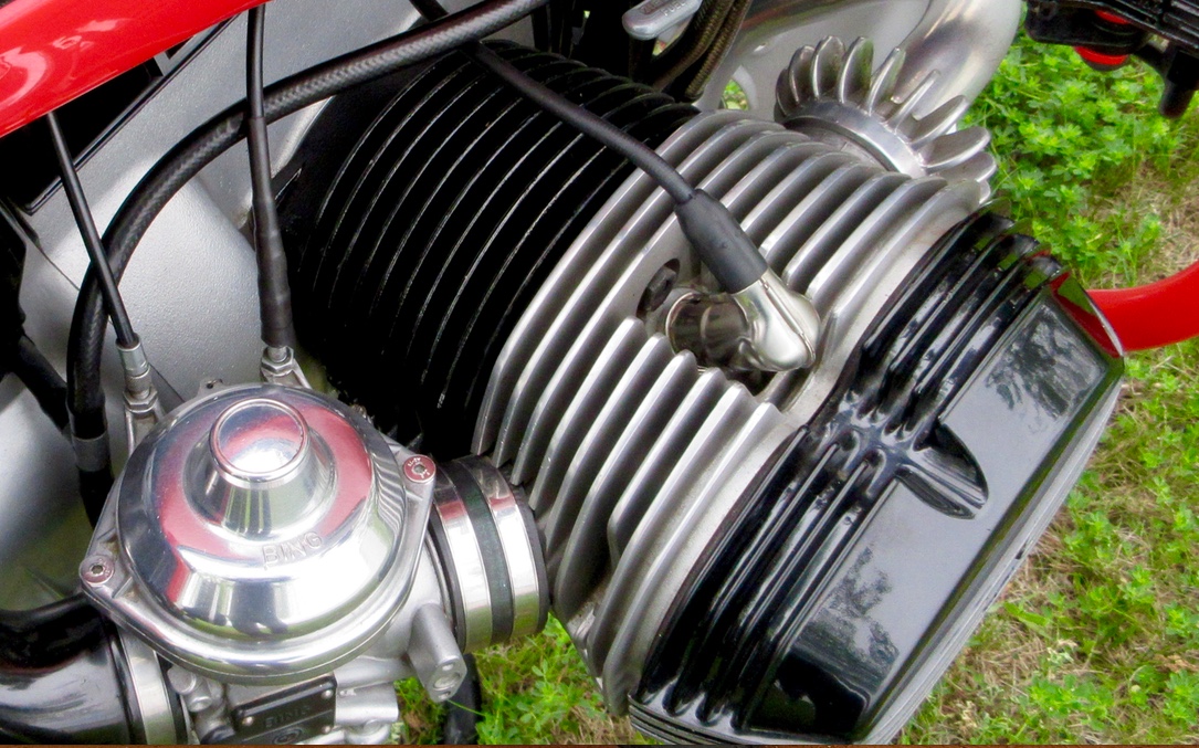

Nobody ever notices my large r90s style exhaust nuts and black cylinders :(
vc gasket.jpeg (355.75 KiB) Viewed 984 times
