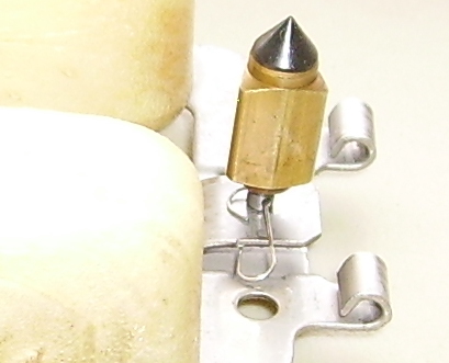

I've never heard anyone do what you have described on any of the airhead forums over the last 17 years. While it may be technically possible to fit a screw adjustment, I wonder if it's a little over the top but I do like the precision approach. I'm not familiar with the detail of those slide carbs but the CV carbs have a wire clip that loops around the tab and through the hole in the float needle pin. The idea is that when the float falls it will positively pull the float needle off it's seat. An adjustment screw would preclude the use of that clip.
Although it's not quite correctly positioned in the pic below it shows the clip I'm talking about.

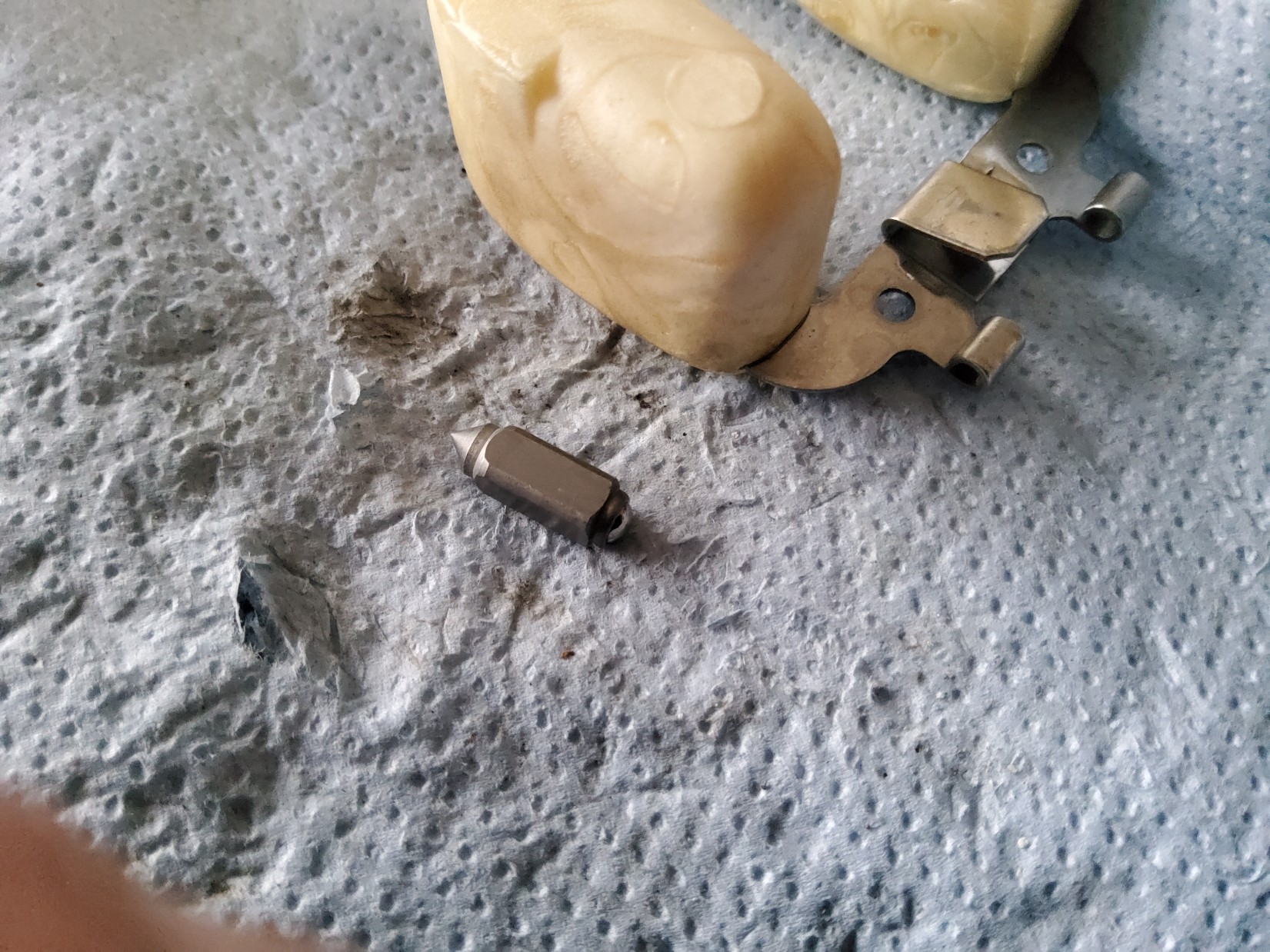

Thanks Barry, the float needle on mine is quite different, with a spring loaded ball end. Hang on, I'll try to get a pic.....

You can see the tab has quite an angle on it, I've now ignored any depth dimensions and am using the parallel method

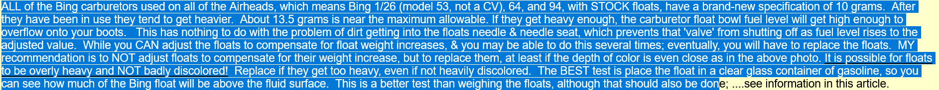

Bing float weight
Snowbum says new floats on all Bings are 10gm.
He also says 13.5gm is likely "maximum allowable". Ongoing adjustment might extend their usefulness, they'll need replacing eventually.
https://bmwmotorcycletech.info/bing-floats.htm
