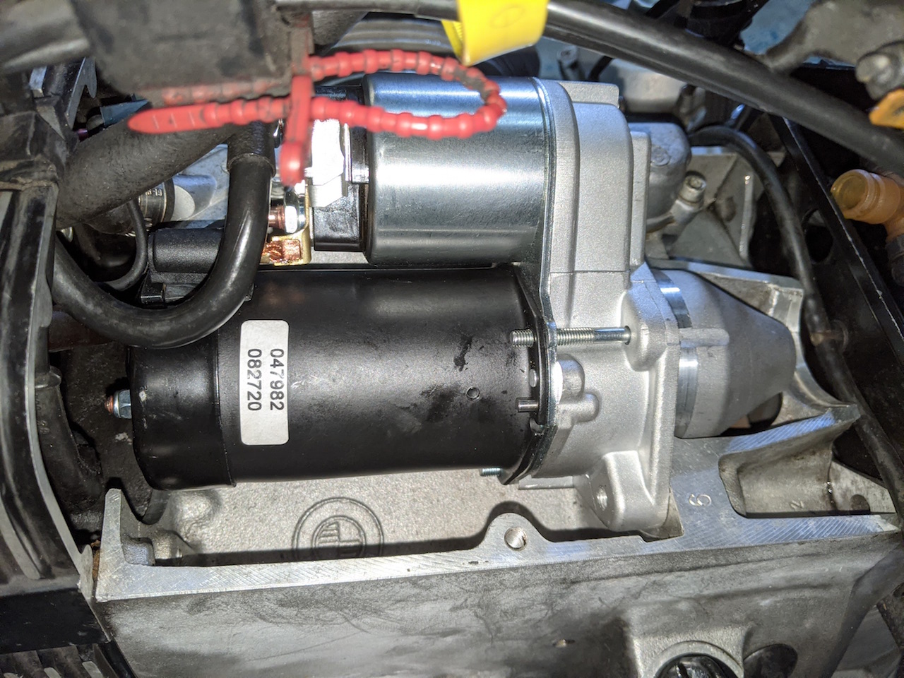

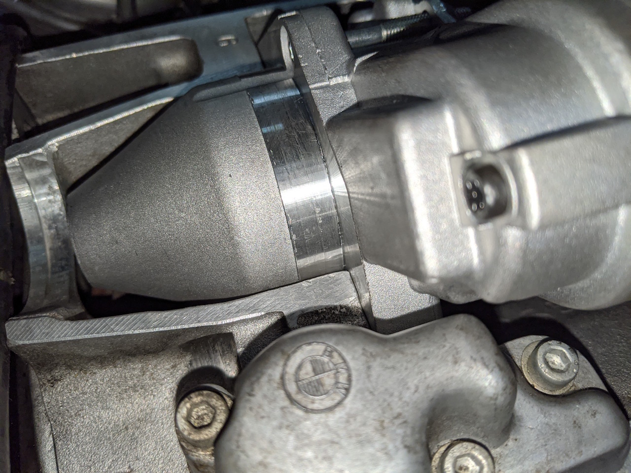

So I've go the new type Valeo starter in place. Bolt holes seem to line up without any problem. I am concerned that unlike my original, there is no bracket on the rear of the starter. So the body of the starter, when bolted down, would be suspended without any support. I guess I could fabricate a bracket or wedge a bit of rubber under the body of the starter? How does the nose drive gear mesh with the flywheel?
Here is the starter in place but not bolted up:

- PXL_20210214_010740850.jpg (377.44 KiB) Viewed 1296 times
- PXL_20210214_010652679.jpg (398.77 KiB) Viewed 1296 times

Thew Valeo type starters, being considerably lighhter and slightly shorter than the bosch type, don't require the front support. There's no need to be concerned about it, there were many thousands of post '85 airheads fitted with Valeo starters and not one of them had a support. No issues.
- The drive pinion is on a drum which slides on splines on the drive shaft. (Note. on a Valeo starter the drive shaft isn't the commutator shaft, there is a planetary gear set to increase torque and reduce speed between the two)
- The drum includes an overrun clutch so that the engine won't drive the starter motor if the starter is kept engaged too long.
- The clutch is moved away from the body by a forked lever that runs in a groove on the drum. The other end of the lever is attached to the solenoid slug.
- When the solenoid is actuated, the slug moves backwards (away from the flywheel) so that the lever moves the drum forward (towards the flywheel) bringing the gears into engagement.... a spring moves it back out of engagement when the solenoid is released.
- In contrast to an inertia starter, the gears are engaged before the motor starts to turn.
- The teeth on the drive pinion and those on the flywheel are chamfered to ease the engagement of the two gears.
