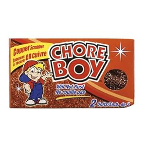

Old School Solution
Post by vanzen »
The old-school method to reduce oil blow-by into the intake / carb(s)
involved stuffing a small copper scouring pad into the oil condensing chamber.
(through the pipe-cover at the front of the block)
This pad acts as a "separator" by providing significant surface area to collect condensed oil,
leave it in the chamber, and without affecting crankcase pressure.
Oil that would otherwise be blown right into the intake ...
Cost ?
A package of 2 "Chore Boy" pure copper scrubbing pads,
@ $2.50 + time to install.

I used stainless in mine. I've thought about running it back into the carbs since just about zero oil is coming out the breather, mainly water in the catch reservoir. I've been told that any oil, even the oil that's supposed to be there robs power during combustion. Probably wouldn't be an issue with my new top end, put it would be more PC and the slight amount of vacuum from the carbs might actually help reduce resistance in the blow by chamber. During the damp cold winter months here in the NW, it's amazing how much water condenses into the oil.

That's a good idea Vanzen, and strange that it wasn't done by BMW?
I'd imagine the service life of the scrubbing pad material in this situation would be considerable.
I shall do likewise next time my anlasserabdeckung is off.

ME 109 wrote: I'd imagine the service life of the scrubbing pad material in this situation would be considerable.
Recently removed a copper "scrubber" from a condensation chamber after @ 30,000k miles of service.
It was oily but unscathed.

Chuey wrote:Then, the conclusion is that oil doesn't damage copper?
If one will be stuffing a pot scrubber into the engine's condensation chamber
I would strongly suggest a material that will not deteriorate, disintegrate,
or otherwise be adversely affected by oil, water, or heat.
Pure copper or stainless steel might be good choices ...
Copper clad plastic might not be a good choice due to the possibility of melting.
Plastic might not be a good choice due to the possibility of melting.
Steel wool might not be a good choice due to the possibility of rusting.
etc.
