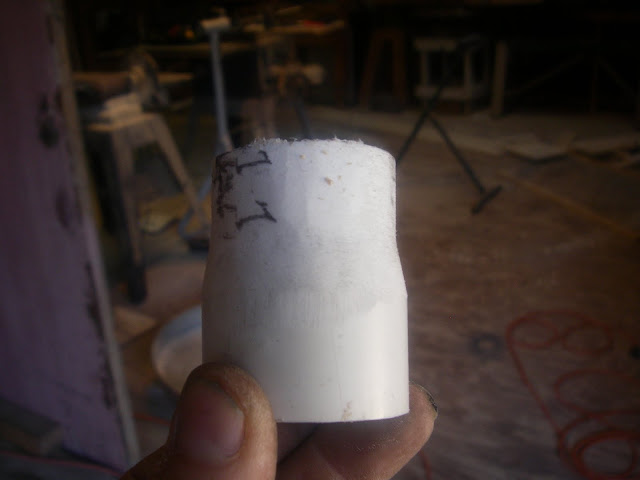

It was the brushes!
Ken would have been proud of me too. I turned a 30 minute job into an hour job by manufacturing a brush retainer for putting things back together. It worked great!
