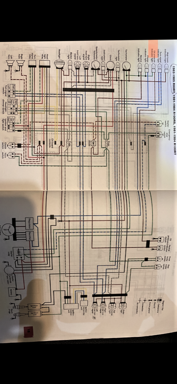

Questions 1 and 2 were correct. So I went to question 3. Input the bike in gear and both wires have ground with the clutch in or out. Didn’t make a difference.
I will send another photo with better resolution. But this limits it to 2 mb.

gspd wrote: ↑Sat May 01, 2021 5:39 pm OK back to first base then,
(Nothing personal Seth, I'm just not a multi-tasker, it's highlighted on my resumé)
cpazambrana... please stick to the questions, no other tests (for now) please
You can leave your ignition off , I'll let you know when to turn it on.
Now to reiterate....
Connect the clip of the test light solidly to BATTERY POSITIVE terminal.
QUESTION #1: Does the brown clutch switch wire have GROUND?
QUESTION #2: Does the brown/yellow clutch switch wire have GROUND when you pull in the clutch?
your answer was yes, ground to both wires, clutch in or out, correct?
if correct continue to question 3
QUESTION #3:
Now do the same test with the bike in gear.
Do both wires still have ground? with the clutch in or out?
PS - A better quality pic of your wiring diagram won't hurt.
- Wiring diagram BMW (2).png (1.26 MiB) Viewed 1037 times

Re: Does not starts in gear
That pic is a lot better, gonna need it later.
Ok , so you always have ground to both clutch switch wires, in gear or in neutral, clutch in or out, correct?
