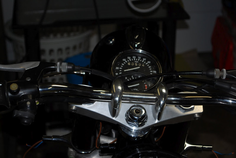

I made good progress on putting the front forks back together. I rotated the fork tube holes so they are pointed inward and measured the 160mm protrusion from the lower fork clamp. I completed making the fork paralellism tool. After learning how to slide the device up and down the fork tube without massive changes on the dial indicator I was very happy with the results, mostly .000 to .002. I Rub-N-Buffed the fork sliders and than started working through a combination of Duanes fork procedures while injecting the procedures from Stephen (Toaster Tan) to install the top brace I bought from him. While I was at it I added a ground wire to the front blinkers. I still have not determined where to ground the wires in the headlight shell but the wires have been put in place. I installed the new 13 rib gaiters (anybody need some premounted but otherwise new 11 rib gaiters) I also got the handlebars loosely mounted and the headlight shell mounted. That was a relief because everything was kinda hanging there all tied up. So, I am not done with the fork job yet. The lower brace was straightened but is not installed yet and I haven't added the fork oil yet, dampner needs installed also. All in all taking my time and as some one else said, sitting back and contemplating my next step with no rush definetely is paying off. I can feel the force of Zen and the art of motorcyle maintenance is strong in this garage :lol:
On to the pictures!
The Toaster Tan top brace.
YAY the forks are back together! The Rub-N-Buffed sliders turned out nice. Now to see how long this finish lasts.
Kind of a wiring mess but It is as organized as I could get it. I see a couple unused ground tabs mounted to the bucket. I am wondering if this is a good place to ground the front blinkers. Seems like the headlight bucket does not have a solid connection to frame ground. It is rubber mounted. What do you think? This picture reminds me of one of those movies where the face of an android robot comes off and you see all of it's circuitry haha.
73' R75/5 LWB
Deleted User 72
Re: My /5 rebuild intro.
Post by Deleted User 72 »
For a /5 bucket that is neat, indeed.
Motorhead
Posts: 391
Joined: Mon Aug 09, 2010 8:30 pm
Post by Motorhead »
In the Main Loom of wire there IS a brown wire, that what grounds the headlight to the loom that attaches to the mount near the coils
