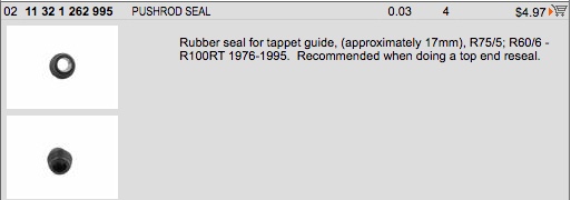

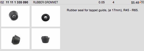

gspd wrote: Thu Jul 21, 2022 6:44 am Are you sure you are using the correct pushrod seals?
r65 seals differ from other models.
I'm 95% sure they're the correct ones. From what I can see from the images you posted, the ones *not* for my r100 don't have nearly as exaggerated ridges on the section that inserts into the block. Also, I was assisted by an "airhead guy" at the shop I went to for parts (SoSo Cycles in Fife, WA, USA) that seemed quite familiar with these motors and knew a good deal of information that lead me to be pretty confident in his recommendations, for the most part.
