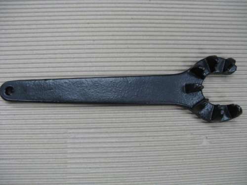

First time on the Ah-8-Tee that I have tried to remove the exhaust nuts so I put anti-seize on the threads.
Used exhaust spanner.
Right nut comes off no probs. Left nut. Even using a hammer on the spanner the nut wont move. Looks like in the future I will be cutting that nut off. Wish whoever did the maintenance on this bike previously had applied anti-size paste to the threads. FARK!

I will try to remove the offending nut when the engine is hot. If not I have been reading up on how to cut the nut off. Use either a Dremel with small cutting wheel or drill 4 holes in a row. Easy by the sounds of it. No great rush to do this just yet.

Ross wrote:I will try to remove the offending nut when the engine is hot. If not I have been reading up on how to cut the nut off. Use either a Dremel with small cutting wheel or drill 4 holes in a row. Easy by the sounds of it. No great rush to do this just yet.
That's MUCH safer than trying to break a stuck one loose.
