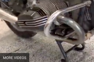

she’s running once more. :D
Boxer Biker Log
Posts: 1133
Re: Parts sourcing - Top-End Rebuild?
Good job!
Sounds a lot better than your first video.
https://www.youtube.com/watch?v=barWV7RWkq0
Are you sure you have the valve covers on the correct sides?
The fins on the covers should be parallel to the header pipe, yours look angled down at the rear.
Inside each cover it will say left or right in german.
Rookie mistake.
Might just be camera angle.
