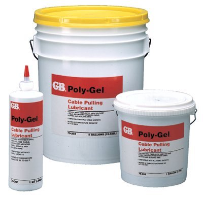

Pay attention to keeping the wiring loom straight and not twisted up. I am trying to remember the slang name for the goop that we put on the wiring portion that gets pulled through the rear frame section. It is made to lube up wiring for pulling through narrow places.

This is the stuff I use. "Cable Pulling Lubricant" or "Cable Pulling Gel" seem the be the most common terms. The big home stores all carry it.

Major Softie wrote:This is the stuff I use. "Cable Pulling Lubricant" or "Cable Pulling Gel" seem the be the most common terms. The big home stores all carry it.
We use that stuff by the buckets at work. (electrician)
For home projects, I use a little liquid dish soap, if need be. That
way, one doesn't have a whole bottle full of the stuff sitting on the
shelf for years and years.
