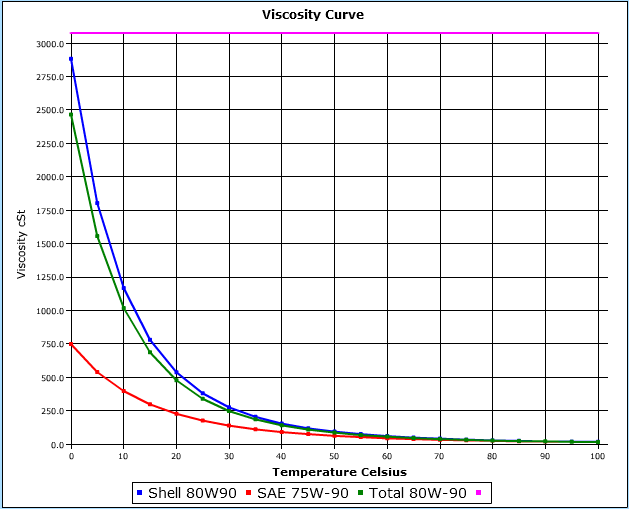

I've had synthetic 75W90 in all 3 parts of the transmission for several years. No problems in terms of leaks and the oil is much thinner when cold which reduces drag. With the bike on the stand and cold oil try spinning the rear wheel by hand in neutral. You will feel substantial oil drag. Do the same when the oil is hot and the difference is incredible. 75W90 reduces much of that cold oil drag.
Look at the difference in cold viscosity between two different mineral 80W90's and a typical synthetic 75W90. The way I look at it we lose a lot of power between the flywheel and the rear wheel and if I can get a few percent of that back for negligible cost it's worth while. I do daily short commutes where the oil never really gets hot so I probably benefit more than most.

Inserting graph. probably going to use it next change. Is the same true for engine oil? I've never tried synthetic in the motor either.

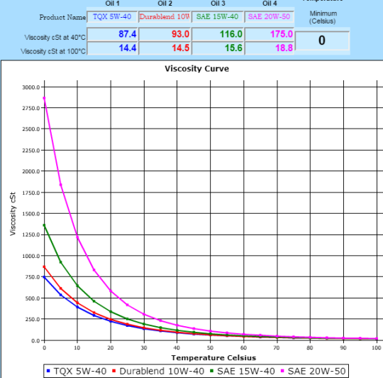

I currently use a 5W40 synthetic for engine oil for much the same reasons as my oil hardly ever gets up to temperature. Many people think that a 5W40 is vastly thinner than 20W50 but it isn't except when it's cold. BMW's oil grade tables permit the use of a 5W40 in my climate so I have no hesitation in using it.
5W40 vs 20W50.png (61.15 KiB) Viewed 2837 times

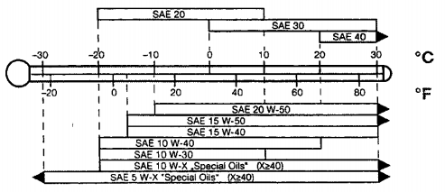

However the manuals supplied with our bikes over 40 years ago are not BMW's last word on oil recommendations. Updates were issued on several occasions in the form of service bulletins and as late as Dec 1995 they were still updating oil guidance for models as far back as \5. This guidance gradually accepted the use of thinner synthetic oils and gave owners a wider choice. The only stipulation about using synthetic even in a \5 was not to do so until the engine had run 6000 miles. The oil chart that I use which permits the use of synthetic 5W40 is this one.
