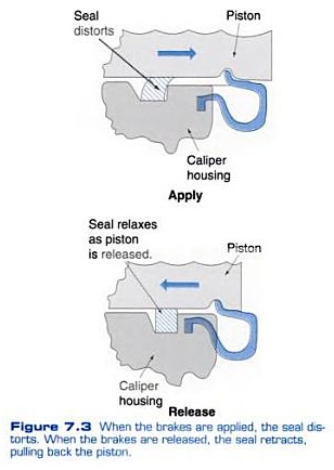

The distortion of the square-oring seal between the piston and the caliper housing is what pulls the piston back after brake application. To a smaller degree, the eccentricities of the disk might "slap" at the pads to push the stack farther into the caliper.

Kurt in S.A. wrote: Tue Apr 13, 2021 6:36 am The distortion of the square-oring seal between the piston and the caliper housing is what pulls the piston back after brake application. To a smaller degree, the eccentricities of the disk might "slap" at the pads to push the stack farther into the caliper.
That is exactly what should happen but only if the pistons are free of corrosion and lubricated. I assemble caliper pistons using red rubber grease and that keeps them moving freely. If I went out to the garage now and spun the front wheel by hand it would keep going for over a minute only being slowed by the bearings and seals.
