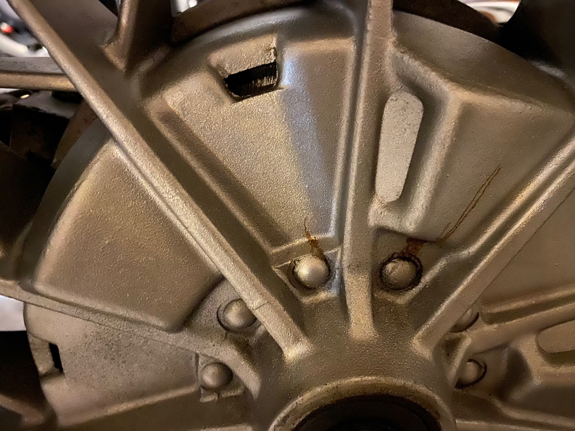

Hi to all. I’m new to the forum and first time owner of a 1983 R80RT. I wanted to say hi and to get some knowledge from your experience. The bike has developed a slight leak through the rear wheel hub rivets. See photo. She was leaking through the vents but I changed the oil to a heavier one and it stopped. But is still leaking through these rivets. No problems with the rear brake so I don’t think is that bad. Is it time to a FD seal?

The first thing you need to do is to take the wheel out and see what's happening inside the brake drum. There is no way that those rivets should be exposed to oil at either end so, unless there's copious amounts of oil leaking through the output seal or the brake cam shaft, those stains aren't coming from that source.
You also need to check that those rivets haven't worked loose. That wouldn't be good.
Quite what the stains are, it's difficuklt to say. I'm thinking maybe spline grease from the drive splines.

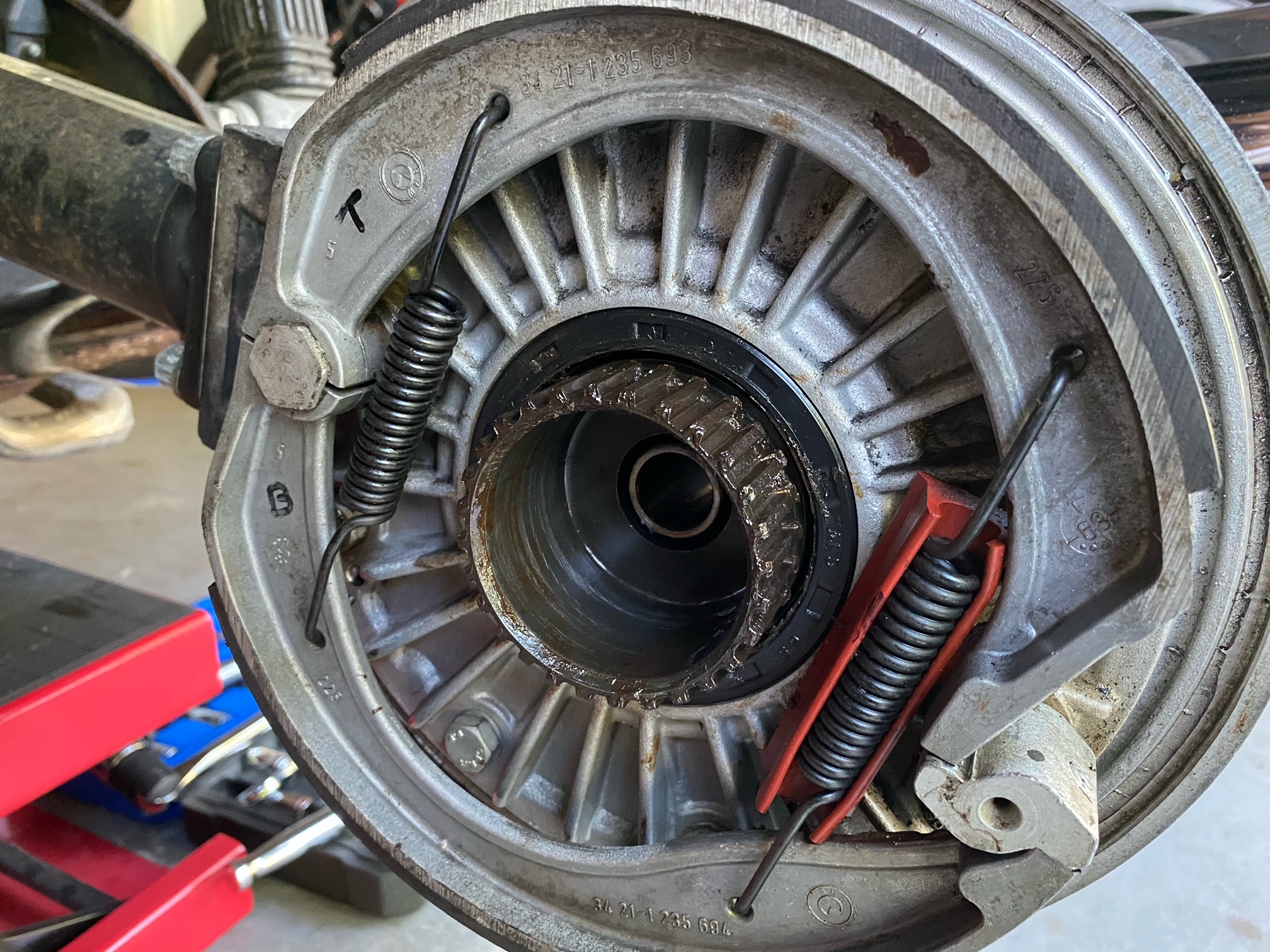

Welcome to the forum! I agree that looking at the brakes would help a lot. On my /7, there is a drain hole on the right side of the final drive. This is to allow any oil that accumulates in the well inside the final drive to leak out, giving the owner and chance to see there is a problem before it becomes a serious issue...as is oil on tire, ineffective brakes, etc. Often times that can get plugged...usually just a pipe cleaner up the hole will clear it...that can be seen when the wheel is off and looking at the backside of the final drive housing.

It's not so much of a plug as a "cup" that runs around the edge. If you get the wheel off and look past the inside edge of the final drive down at the 6 o'clock position, this is where any oil would collect...that's also where the drain hole is to the outside. Can you take a picture of the final drive from the right side, maybe from the ground looking up under the muffler? We could then see where the exit hole is.

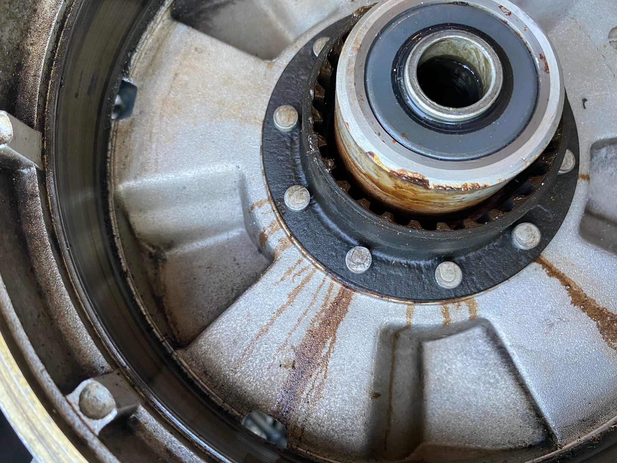

Guys. The leak came from behind the spline wheel in the hub. It seems like old grease or excess grease there. FD is dry and I saw no leaks. See photos. I guess I would leave it like that for now as I don’t want to mess with it. What do u think? The

Check photos.

Final drive
