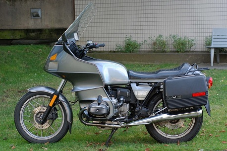

Having owned several airheads, I agree that getting the bike up on the center stand should be easy. It is obvious when looking now(and comparing to the photos posted) that the center stand on my 83 R100RT is worn out.

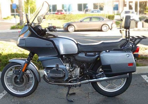

My new to me 1995 R100RT arrives next week and it will be interesting to compare the 2 centerstands and their angles. I am assuming the '95 center stand will be in good condition since the bike only has 19K miles.
**if you compare the two photos, you can see the '83's center stand has a much more severe angle compared to the '95 - *the grass under the '83 was very soft after a rain so the front wheel isn't up in the air - on cement, the 83's wheel us usually 3-4" off the ground

Yes, your '83's stand looks a tad worn. The monoshock's center stand is much wider and more stable, and its splayed "feet" will make it much easier to step onto the left foot to lift the bike onto the stand. The later stand does not, unfortunately, transplant to/fit the earlier twin-shock bikes.
