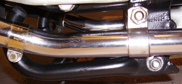

That is exactly what I found in every respect. No question that a well repaired stand will be much better than new and last a lot longer. I thickened up the tips with weld on both sides to increase the area of contact.ME 109 wrote:
The main reason the stands wear out is the pathetic design of the top of the stand. It's just the tube squashed together which gives quite a thin section, and small surface area.
There's also the alignment of the stand top and frame lug to consider. The stand tops can be too wide as set by the bushes, making for even less contact with the frame lug.
The welding of my stand in the pic increases the width of the stand top, which matches the frame lug width.

Thanks!picturethis wrote:that was a nice clean weld job you did in the photos.
Barry's stand looks to be an upgraded 82>? going by the position of the spring attachment. It should be 240mm pivot centre to bottom of foot. The 10mm shortening of this stand compared to the 250mm 81 stand was BMW's answer to make the stand easier to use.
When attempting a weld repair, the first thing to assess is where the stand needs to be, compared to where it is.
I put a jack under the bike and lifted it until the c/stand looked to be where I wanted it. I could measure the degree I spose.
Then I looked at the gap between the stand and the frame lug to see where weld was needed. In my pic you'll see the weld is offset. I didn't weld where there was no contact.
The frame lug contact area needs to be in ok condition to start....as well as the bushes, and holes for the bushes.
The frame lug is an immovable object, so the weld repair to the stand has to closely match the frame lug shape, on both sides.
The weld repair should be angled as in my pic, to fully contact the angled contact area on the frame lug.
I put my bike up on two 3" thick timbers, and one for the side stand. This allowed the centre stand to swing freely under the bike without touching the ground making trial fitting easy, and allowed me to fine tune the weld shape so full contact occurred on both sides, at the same time.
