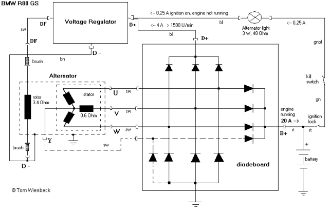

He does indicate a 50 ohm resistor could be used, connecting one end directly to the input side of the coils. He also says that the resistor could get very warm. Is the resistor still working? What if it has failed?
Remember, the resistor is only used to help continue charging if the gen lamp bulb fails. So, if the gen lamp is still working, the added resistor really has nothing to do with the circuit.
Sounds like you should follow the steps provided in Rick Jones' Boxer Charging book. Something else must be wrong.
Re: generator light staying on conundrum
If shorting DF to D+ makes the alternator work then the rotor can't be faulty, at least not at the revs that you used.
In order to test out the whole alternator bulb wiring circuit including the resistor how about making up an external link wire with a resistor or a bulb (it doesn't mater that it's a standard alternator light bulb, any low wattage bulb will do) and connect it across D+ and battery +ve.

A lil more specific info... I have an LED light that is connected where (replaced) the original Gen. Light. Since the LED does not have enough resistance I have attached the 50 OHM resistor to the coil and VR. This was well over a year ago and the new LED gen light has worked flawlessly until now. I have replaced the resistor with a new one so that is not the issue. I have replaced the Voltage Regulator with a new one as well. I have by passed the VR and jumped appropriate wires a number of times and everytime I get voltage increase with acceleration from the alternator...
Someone recently knocked my bike over and picked it up. In doing so the broke off the (tab)of the kill switch. Apparenty put a lot of force on the switch when picking up the bike by the handlebars. Could there be something in that switch that is now faulty that could cause this issue?
