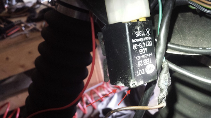

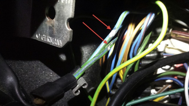

I cracked open the headlight bucket and noticed a couple of wires that have obviously became overheated. The green with blue wire runs to the coil, the blue with green wire runs to the kill switch. I checked for continuity on both wire and it seem there i no break. the wires, where connected in the headlight bucket were resting on a relay there. That relay was melted a bit where the 2 wires were resting. hmmmm
