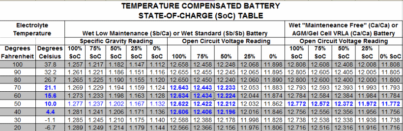

Roy Gavin wrote: Thu Aug 10, 2017 2:47 am ...or is there a range between 12.6 and ,say, 13.2 which qualifies as fully charged.
It varies so much that generalisations can only be a guide. My battery came with a detailed data sheet that specified rested open circuit voltage vs temperature and state of charge but even then there is a range of acceptable values. If you measure the battery when new then you have your own benchmark. Mine was a remarkable 13.05 volts.
This table gives generalisations but there are so many subtle variations in battery chemistry and construction that the manufacturers figures and your own experience are the best guide. For example to say a wet cell is 12.6 volts doesn't really pin it down as modern wet cell car batteries like the one in my car are more like 12.7 to 12.8 volts.
For what it's worth here is a standard table but as already said modern wet cells will be higher and some AGM's and Gels can be higher.
SOC Table.png (59.29 KiB) Viewed 3917 times

barryh wrote: Thu Aug 10, 2017 3:41 am If you measure the battery when new then you have your own benchmark. Mine was a remarkable 13.05 volts.
Great table ! Thanks.
I'm simply wondering if your reading and the table numbers are simple voltmeter readings or those made with a battery load tester.
I agree, there are so many battery types that the one-size-fits-all days are over. That's why I say the little slip of paper in the box with the battery is so important. 40 years ago, when there were only flooded wet cells available, they all pretty much said the same thing. These days it really pays to read and understand that information.
