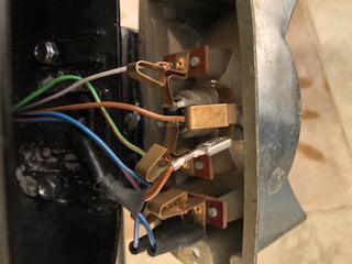

I disassembled the brake light & turn signals as I needed to make a slight rear fender repair, taking note of the original connections, so I am puzzled... here is a picture.
Do you see anything wrong? What does the green/red wire do?

Green/Red is the brake lamp, Grey/Black is the tail lamp. Right indicators should be Blue/Black and left should be Blue/Red.

If one of you're bulbs isn't working while all the rest are, it is a pretty good assumption that the problem originates in the wiring to that bulb. This means you are looking at the Blue/Red wire that leaves the connecting block in the headlamp shell and runs the length of the bike to the rear lamp housing, or the Blue/Red wire from the rear lamp housing to the indicator housing or the brown ground wire back from the indicator housing to the rear lamp housing. We can eliminate the ground wiring beyond the rear lamp housing because this is shared by all of the other lamps in the rear cluster and both indicators... if it was bad, none of them would work. Equally, we can eliminate the wiring from the indicator switch to the connection block because, if the fault was there, the front indicator wouldn't work.
You need to check the continuity of each of the three wires and there connections at either end, You also need to give some regard to the bulb holder. There are several ways to go about this. The easiest is to work through the circuit from one end checking the voltage at various points.
My first check would be at the rear light cluster looking at the voltage on the blue/red wire. This should go from 0 to 12 volts and back in time with the flashing of the front indicator. If it doesn't, there is a problem with that wire.
Given a good result here, I would check the voltage termination if the Blue/red wire at the indicator housing. This should also go from 0 to 12 volts and back. If not, that wire is suspect.
If this is still good, the next move is to check the voltage at the brown wire in the indicator housing. This should always be at zero (or thereabouts) whether the lamp is on or off. If it shows anything more than - say - half a volt, the brown ground is not connecting back to the ground in the rear lamp.
Finally, if you're getting good results in all of these places, the problem is with the bulb or bulb holder. I should add that all connections should be connected and the bulb should be in place when taking these readings.

Thanks Rob! Great explanation and tips. I will give it a try...
