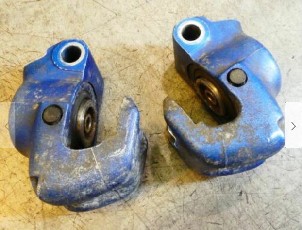

Loose Caliper
First off, I recently started noticing a clunk every time I applied front brakes for the first time after starting to move. Turns out, one of the calipers is loose. Here's a video
https://www.youtube.com/watch?v=lzMuToy4_6o
And a quick album showing left/right calipers and differences. The left side (as if sitting on it) is loose, the right side is solid/doesn't move.
https://imgur.com/a/GxpPJGX
Is there a missing o-ring or spacer here? I can't imagine it's supposed to move like this by design.

As for the brakes, you might be missing the "buttons" that are installed on the underside of the caliper. They are there to help the caliper slide along the lower ear of the fork sliders. I've attached a picture I robbed from fleabay. The button is not available from BMW as a part. It is some kind of hard phenolic. If yours are missing, try finding some Delrin. The button is around 12mm in diameter...not sure what type of hole it fits into.
Good find! I’ll investigate this when the suns up. It’s probably exactly what is wrong.
