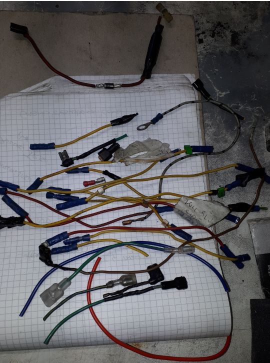

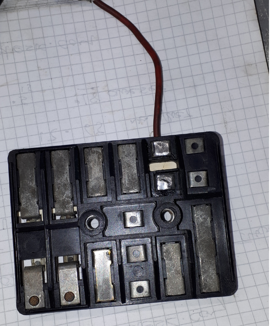

changing the subject slightly but sticking with diodes , i came across this fix in the headlamp shell to bypass the diode on the fuse/connector board in headlamp should the diode on the board go , you can see that a jumper cable has been made up with diode soldered in line and a double spade at one end ( think it was the neutral switch side rather than the starter switch side due to diode direction ) . I will be keeping this bypass cable for temp repair on the roadside.
As you can see one of the previous owners loved yellow cable and crimped connectors which i have removed and made good now in headlamp .
