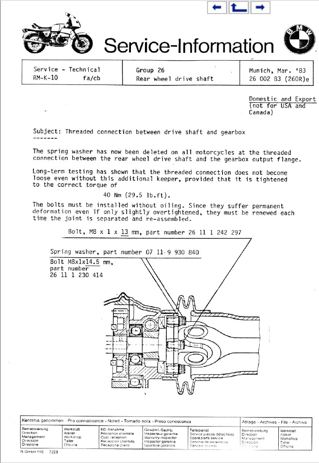

To complete the above, here is the 'domestic' market version of the relavent Service Information:

Interesting that is says the bolts cannot be reused, even if slightly over tightened. That suggests to me, or maybe I'm reading between the lines, that if the bolts are tightened to 29.5 ft-lbs or slightly under, that would not constitute being over tightened and could be reused. Over tightened suggests plastic deformation whereas tightening to spec would keep the bolt within its elastic qualities and thus could be used more than once.
Posts: 1405
Re: Driveshaftbolts
What it says to me is that you re-use bolts there is a real chance that one or more will fail. If it does so, then the damage is likely to be pretty expensive. I gues it all depends if yer feeling lucky... Well are ya...
