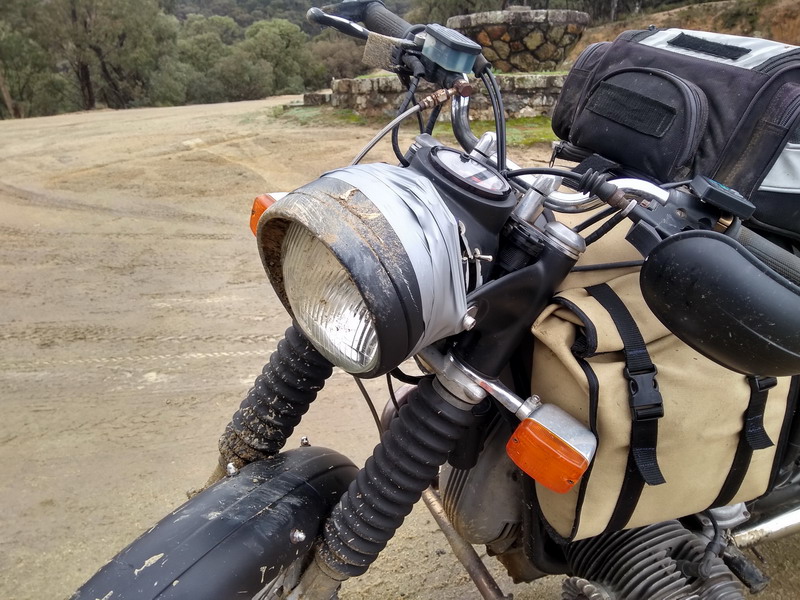

It’s very good to be back on the road after 21 months. We had an ‘off’ on a muddy road back in March 2020 which mashed up the previous printed headlight bucket.

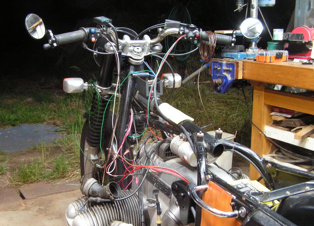

I had already decided to replace the wiring next time the bike was off the road and the Covid lockdowns provided a good opportunity. I had been working on plans to move a lot of the electrical components to the space under the tank where the master cylinder had previously lurked (and leaked) since the headlight bucket was completely full of wires and relays and accessory connections, etc. An ugly, embarrassing mess is probably the best description.

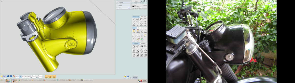

I have been fooling around with 3D printing for 5 years or so. I bought an entry level printer, made a few mods and housed it in a temperature controlled enclosure so I could print ABS plastic. I also bought a 3D modelling program called “Moment of Inspiration” (moi3d.com), which has proven to be ideal for the organic shapes I wanted to model and print:
The bucket and ears are based on the /5 but sized to take a common 7 inch semi-sealed H4 headlight with a very inexpensive chrome ring from a CJ750 (Chinese copy of the Russian copy of a primitive BMW). I have angled the speedo back a bit so it actually faces my face, to make it more readable. The speedo is a Speedhut GPS model, with electronic tacho.

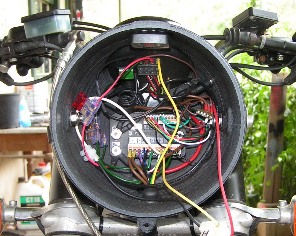

I mounted the Mo-Unit on a printed bracket inside the bucket. Yes, there is some more tidying to do but it is so much better than the previous rat’s nest.

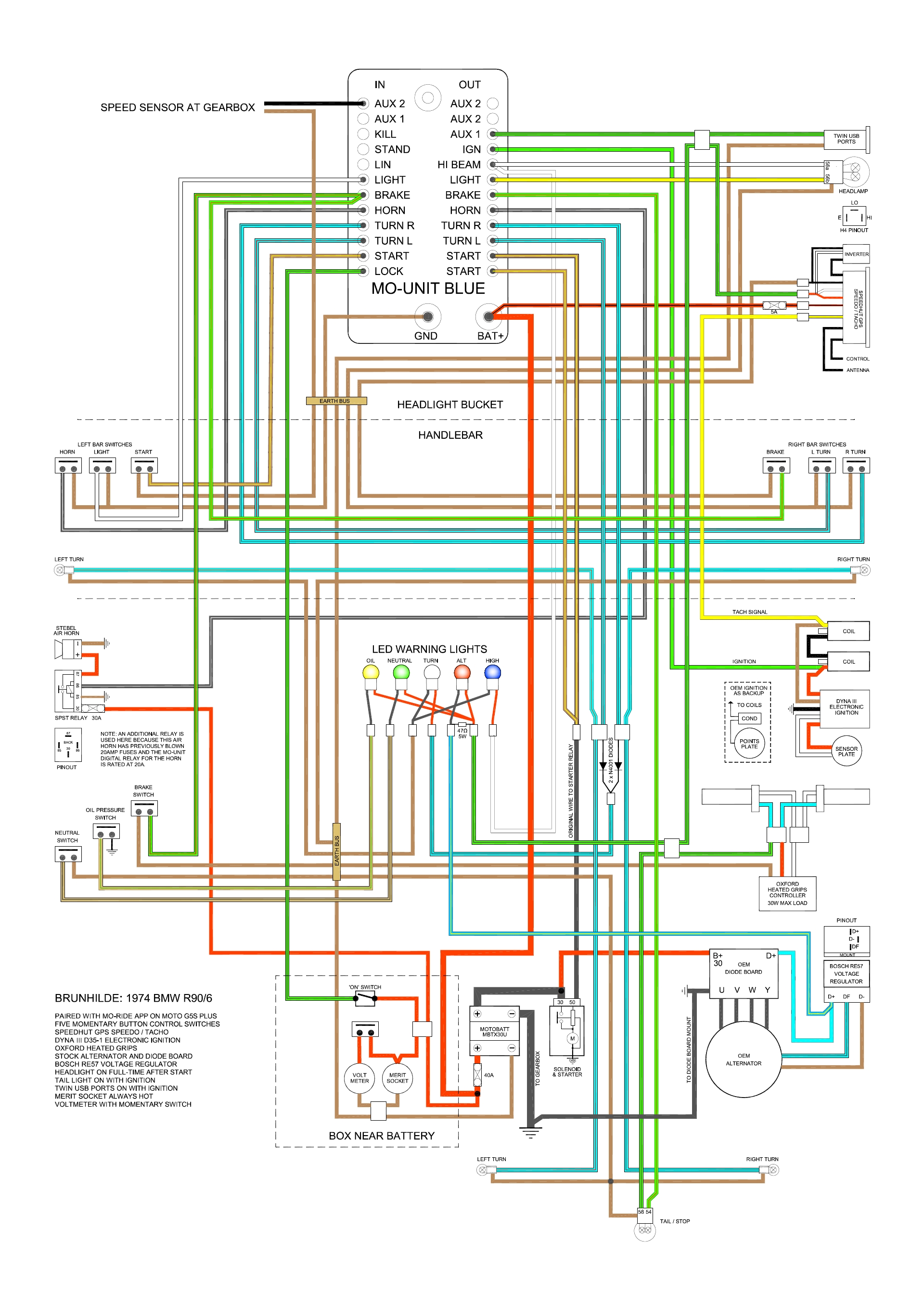

And here’s the wiring diagram. It’s a hi-res image, so if you are interested you can save it to your computer and zoom right in. I did my best to match the original wiring colours.

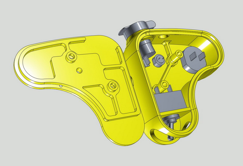

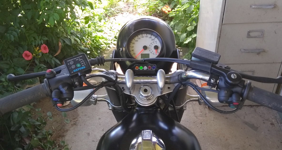

The control inputs to the Mo-Unit are low voltage momentary connections to ground. I was not keen to pay the prices that Motogadget and other companies were asking for the right kind of buttons, and they would have been difficult to fit with the BMW perches. So, some more modelling and printing was required. I managed to design switch housings for the momentary buttons that fit into the original mounts.
The red button on top of the clutch perch is for Ignition On, Start, Kill (double click) and Ignition Off (double click). The blue button is for High Beam flash (short press), High Beam toggle (longer press) and Lights Off (two second press). The orange button is for the horn. On the right are the turn buttons. A short press flashes the selected turn signal 3 times for lane changing and a longer press flashes the turn signal for whatever you have selected in the menu. In my case I’ve chosen to have the turn signal turn off after 10 seconds. There are many options, including turning off after a chosen distance. This feature is a potential life saver – I lost a friend back in the 60s after a car pulled out thinking he was turning. O, and pressing both turn signal buttons turns on the hazard signal.

That's a great bit of work Charlie.
The wiring diagram is a beauty. Too often bikes get rewired and it's hard to know what's what, but I expect you have that well covered!

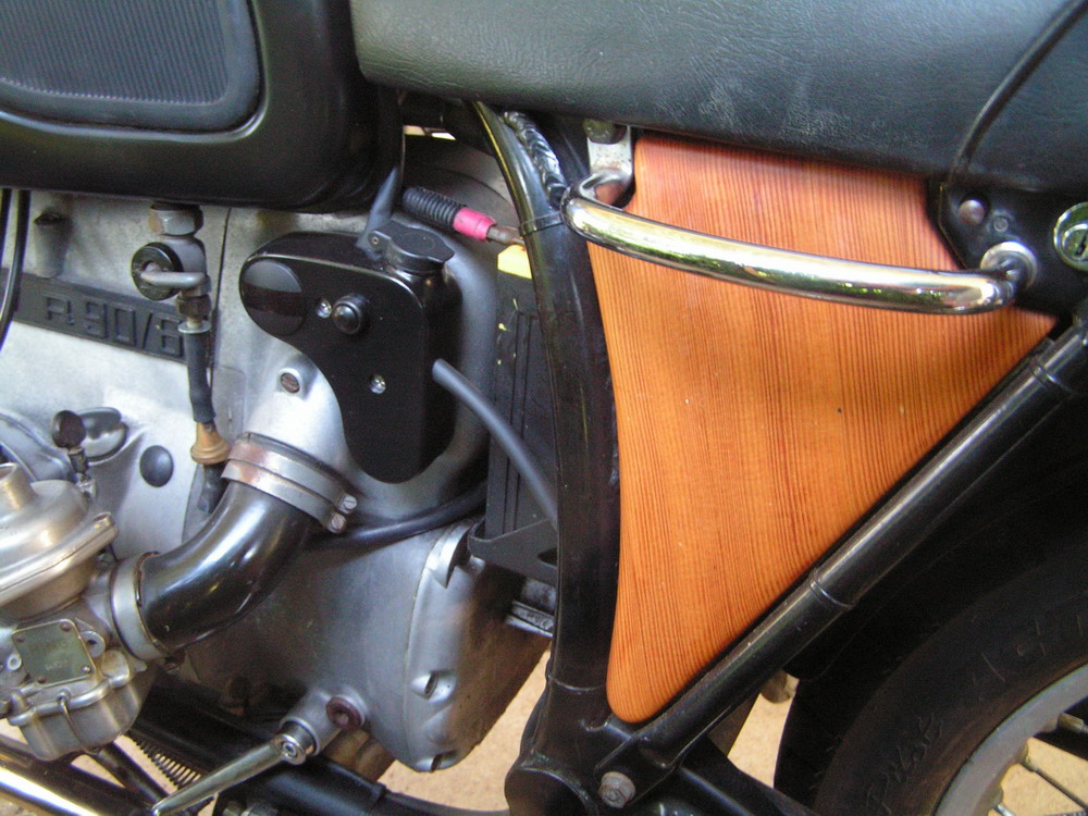

In the wiring map above there are some electrical components indicated as being in “Box near battery”. There’s a Merit socket (always hot, so I can power or charge devices at a campsite), a voltmeter with a momentary-on button (to monitor the available voltage) and the ignition switch, for when I choose to not operate the bike via my phone (more later on this).
To house these components I modelled and printed a box that attaches to the port-side air-box housing where the ‘choke’ lever once lurked:

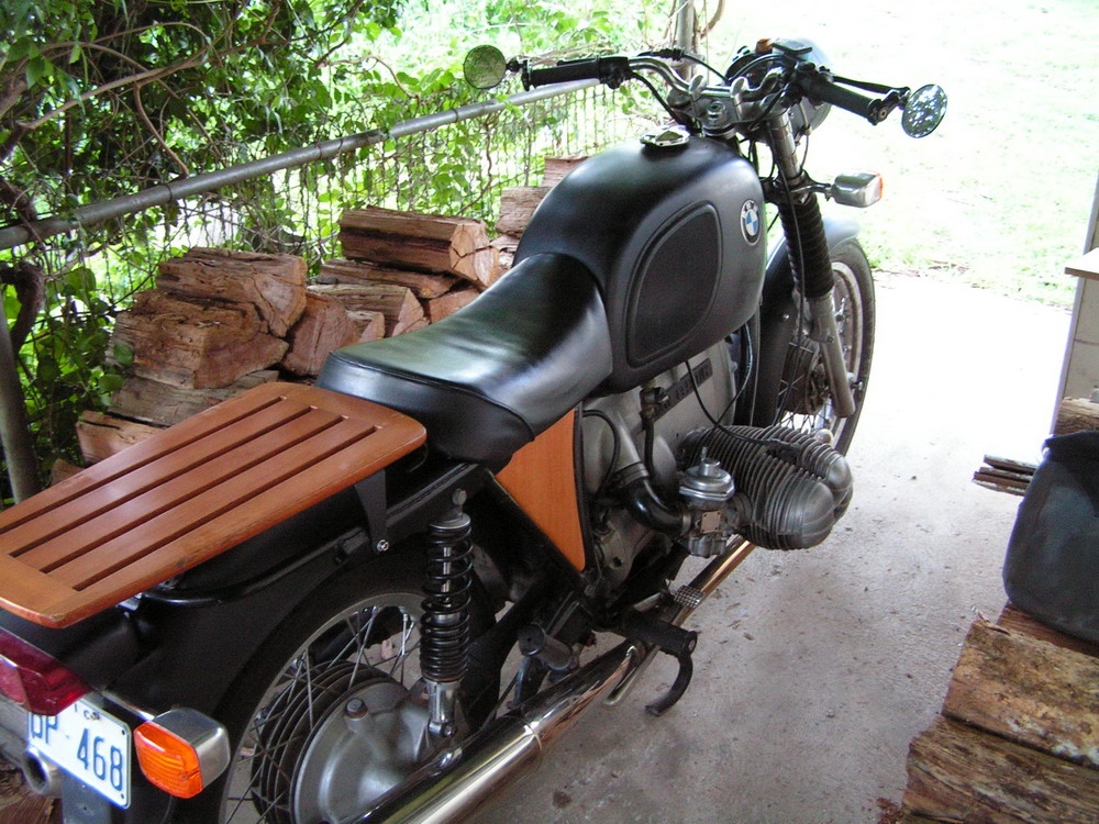

Ah now, that wood was milled from a WW2 Oz Army tent pole, manufactured back when BMW riders were discovering the joys of travelling to far flung places by motorcycle to meet new people and kill them.
It is a north American softwood similar to spruce, and after 80 years is very light weight and strong. Brunhilde’s rear rack is made from the same wood.
And I used the same stuff to make the mast, spars and oars for a boat I built 30 years ago:
I’ve always felt that the OEM side panels were a disappointing attempt at a “cover-up”. They seem to be aimed at hiding the fact that BMWs carry a big, sensible battery but in the process they hide a nicely curved frame member that should be seen and celebrated.

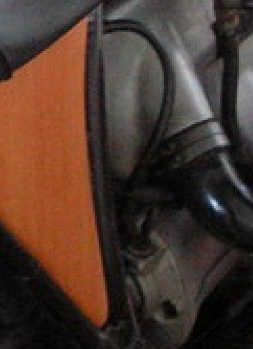

OK, you got me. Although I haven't seen what they look like directly from either side (pics please), your side covers do 'integrate' better than the BMW ones, aesthetically and organically speaking.Airbear wrote: ↑Sat Mar 19, 2022 9:22 pm I’ve always felt that the OEM side panels were a disappointing attempt at a “cover-up”. They seem to be aimed at hiding the fact that BMWs carry a big, sensible battery but in the process they hide a nicely curved frame member that should be seen and celebrated.
Taking into account your electrical prowess, you should take the aesthetics a step further.
Next time you're bored, figure a way to hide that main (not nicely curved) ground wire . It contrasts with the frame curve you are proud of emphasizing and detracts from your hand-crafted side cover. I routed mine over the top, in through the starter cover, and grounded it directly to the engine block case via a starter mounting bolt. That keeps it out of sight and also provides a (theoretically) better electrical path. If that's too much trouble, at least reposition it so it sort of follows the frame curve a bit.

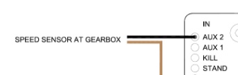

1- Why do you need a transmission speed sensor circuit with a GPS speedometer?
