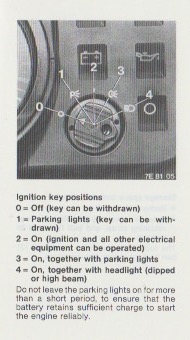

All models DO NOT have the same harness. There are slight differences (and part numbers) between the euro and non-euro harnesses, and also from year to year and model to model. Also, some ignition switches had up to 5 positions (off + 4). Pic below is from my original owner manual but my bike came with a 3 position (off + 2 positions) switch. go figure...
I haven't done one in a long while, I do however know for a fact, after (illegally :oops: ) converting many customer bikes to euro left handlebar switches, that quite a few wires in the multi-plug connector blocks had to be switched around by pressing out the pins and appropriately relocating them. You had to use a multimeter to test and determine which wires went where for everything to function correctly. No wires had to be eliminated or added but in the end the switch plug wire colours would no longer match the harness plug wire colours. I think it was about a 2.5 hour job. These mods varied from bike to bike depending on the year and model. Not a job for the faint of heart, especially if when something effs up decades later.
