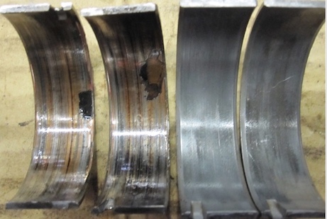

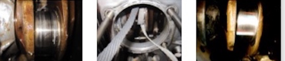

Rob Frankham wrote: Fri Jun 17, 2022 8:46 am you still need to know which to buy.....which is that you can't order big end shells before you know the state of the crankpins.
All you can do is order the stock shells and cross your fingers that the crank is only slightly blued and will hand polish up satisfactorily. You do the polishing with compound and a shoelace and hope for the best. No amount of polishing will reduce the crankpin O.D. enough to fit even the smallest oversize shells available; that would require a crank regrind. You won't remove too much material from the hardened surface by polishing. As far as measuring things, forget it. Measuring any used crank is an exercise in futility. If you precisely utilize the best measuring tools, you'll soon realize that every used crankshaft in the world is out of round and out of spec to a certain degree. That doesn't mean it won't work 'virtually' forever. Precise measuring is only required during and after regrinding to correctly purchase and fit the new shells and bearings.
before and after.jpeg (25.64 KiB) Viewed 1490 times

gspd wrote: Fri Jun 17, 2022 10:18 am
The pics you've provided here and before are both *super* helpful.
I believe that I may have been mistaking the term "Big-end bearing" with "Crankshaft bearing." Just to confirm I am not mistaking this further, am I right to assume that the "Big-end bearing" is synonymous with "Connector rod bearing shells" in this case?
