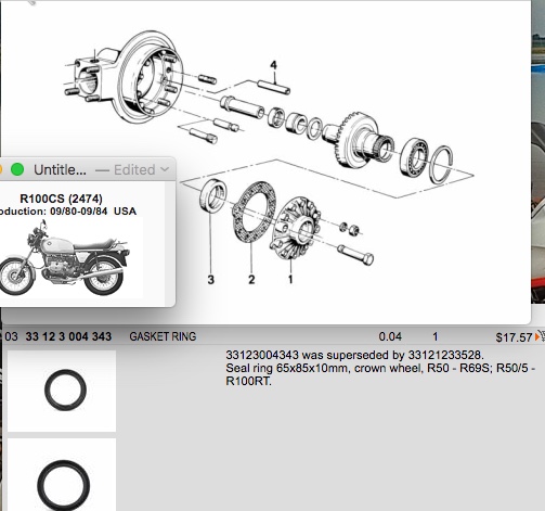

You need # 3 in illustration
Part # 33 12 1 233 528 GASKET RING - 65X85X10
previously was 33 12 3 004 343 GASKET RING
Posts: 5089
Re: Oil in brake hub
Is this it? edit: 1 minute... :D but only 14Kkm away! 8-)
#3...
33 12 3 004 343 GASKET RING $17.57
33123004343 was superseded by 33121233528.
Seal ring 65x85x10mm, crown wheel, R50 - R69S; R50/5 - R100RT.
