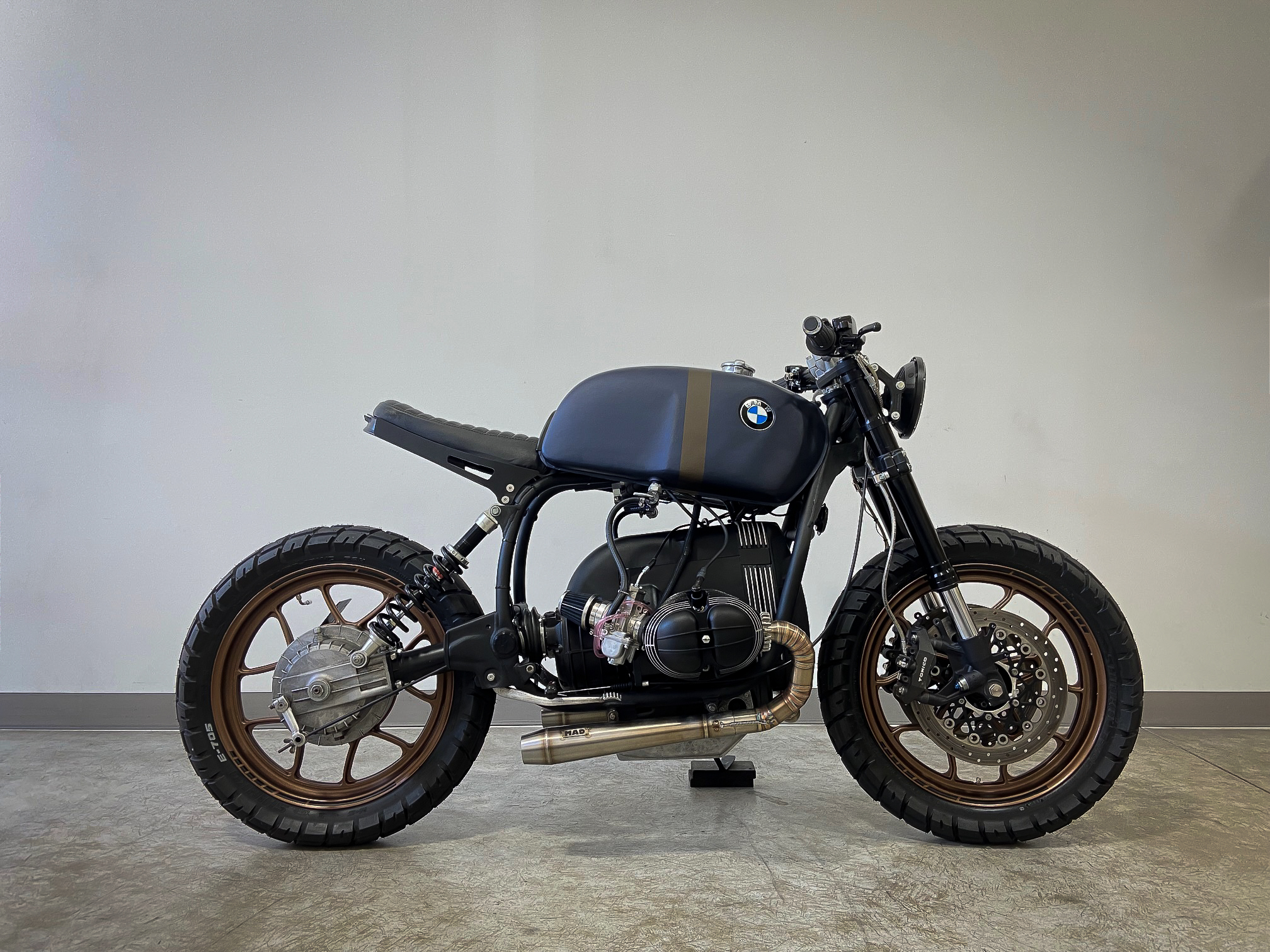

Hey all! I just wrapped up a 1982 R65LS with a 860 big bore. I love the get up and go but the gearing is a bit short. It currently has a 32/9 final drive. Ive got the double shock swing arm and drum brakes so would like to get something that'll mate up. Do any of you have an opinion on what ratio I should look for? Thinking something off an R80 or so...possibly 32/10 or 11. Thanks as always!!
