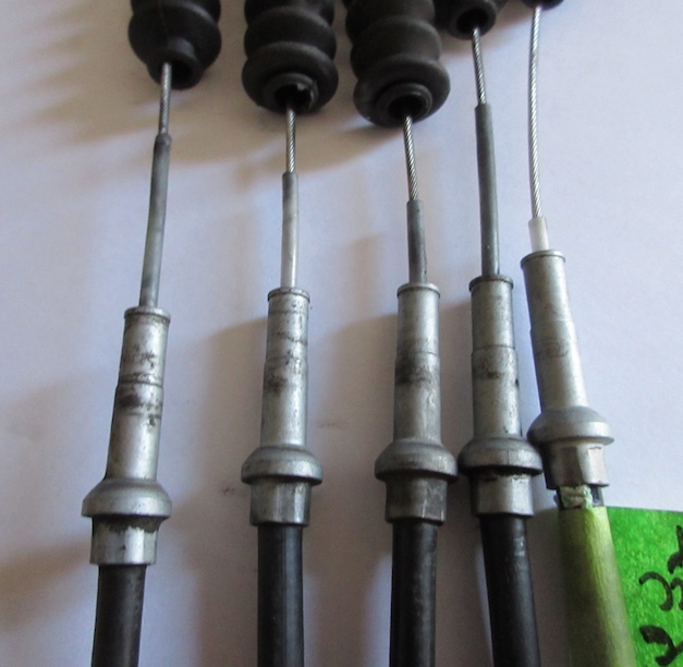

I was looking closely at a bunch of my old cables I had hanging around, none frayed, all 'usable' and I noticed that the nylon cable inner sleeve sticks out more as the cable wears and ages. The inner sleeve is stuck there, it can't be pushed back in or pulled out further. The funny thing is that if I roll the cable up into a 6 inch coil, the nylon sheath retracts to its as new position, only to come out again when uncoiled. The total length of the inner and outer used cables varies quite a bit.
