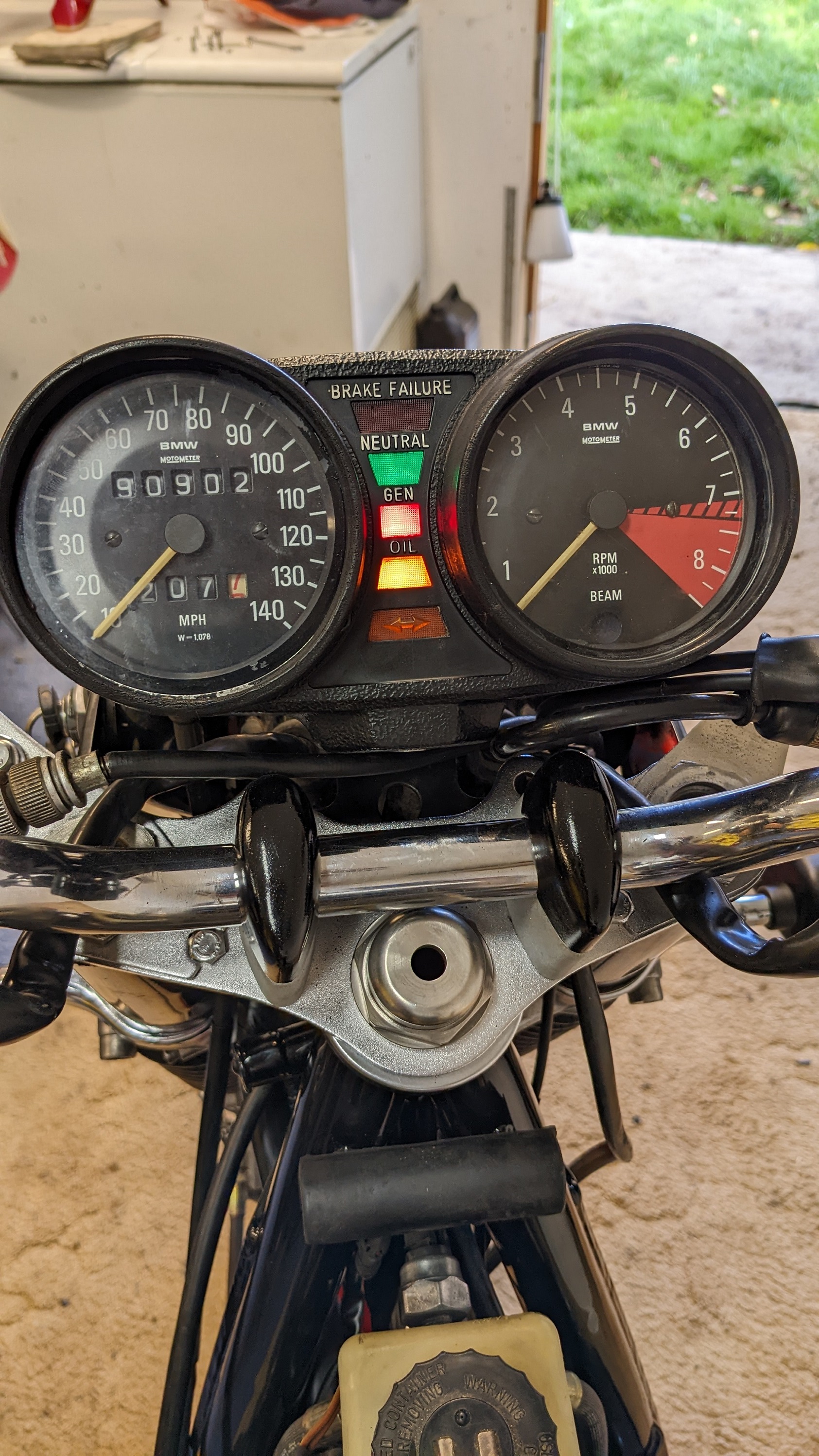

Just checking - I've not worked on a BMW before. These lights look right for a stationary engine I think?
On the indicator switch by the throttle is down supposed to light the right indicators?
Lastly, I'm not getting the brake failure light to come on. I understand that if there is no fluid in the reservoir then it should come on, also if the wires are taken off it should come on right? Neither of these options bring the light on and I did check that the bulb was ok.
