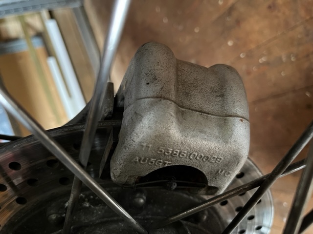

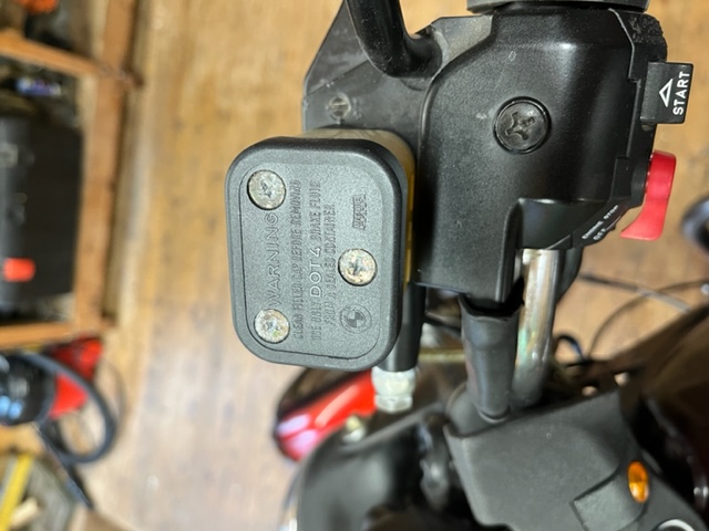

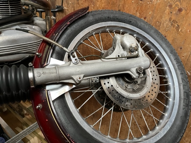

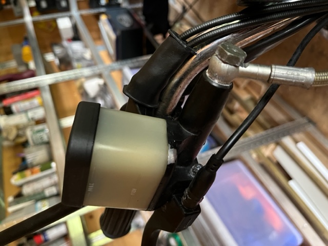

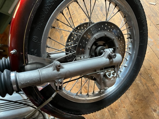

Hi all,
Just bought my first Airhead - 1978 R80/7 with 50,000 miles - the previous owner had the bike 26 years and I have a stack of receipts and invoices to go through, I am after some assistance please regarding the front brake/disk - mine has twin disk which I don’t believe was standard on my model - could anyone identify what I have so as I can look at the parts needed. Thanks

Hi - yes will check the receipts - I intend to make the bike mechanically sound and probably repaint to the original colour which was black and ride it 😄 - for the brake side at the front just seating if anyone can identify which model the brakes came from as the photos I have seen of other bikes same year as mine seem to have only single disk

Nice! The brakes came from any twin disc Airhead from up to 1980. The calipers have either 38mm or 40mm pistons. If they're 40mm, they'll be stamped "40" in an obvious spot.
Is the master cylinder still under the gas tank or is it on the handlebar? Under the tank was as original, but many will use a more conventional handlebar master cylinder as an upgrade.

Those are called ATE brakes. My single ATE stops well enough for me. I would think that dual ATEs would stop even gooder! They require some adjustments to make sure the pad is fully contacting the rotor, plus ensuring that all air out of the lines is important.

Interesting, - mine does have a master cylinder on the handle bar, it’s a UK supplied bike from the info on my logbook, mine looks exactly like like those photos ? - will check the back of the calliper for any numbers stamped. I have read a few articles about adjustment so when I get my new pads will follow them. Mine does look like original fit but who knows

Looks oem to me. Those discs look well worn though.
Even the handlebar stuff looks oem (from post 9/80 model). The size of it's master cylinder is stamped underneath. The SS hoses are aftermarket and a good addition.
