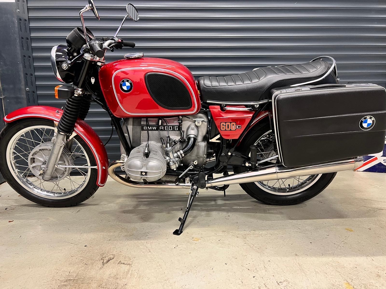

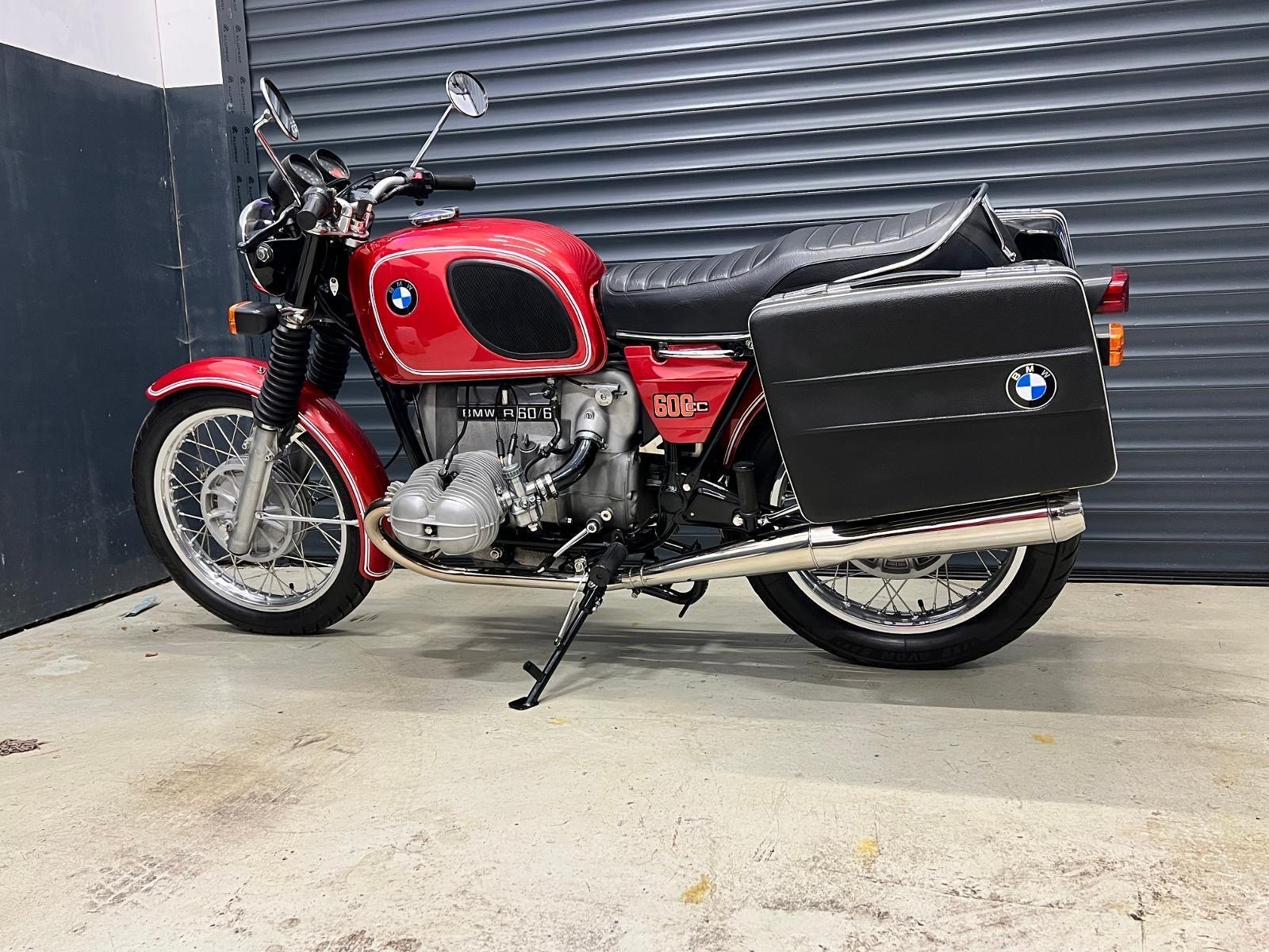

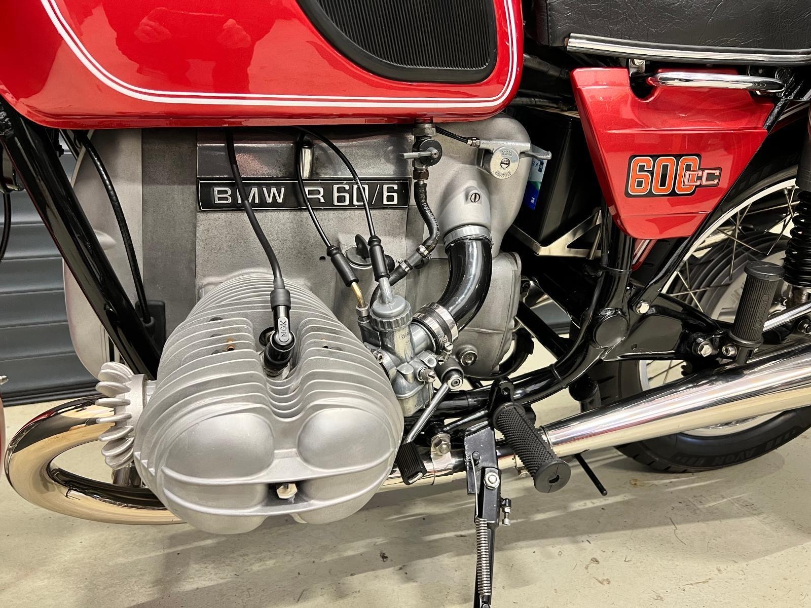

Roy sent me a few photos so here they are. Doesn't it look fabulous.
