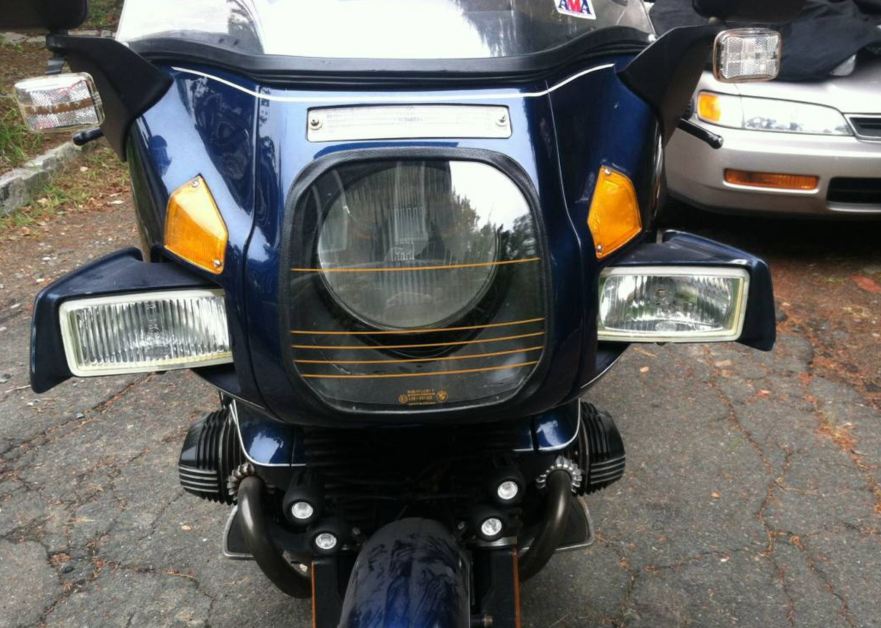

I found one of the leads fell off. It was in a difficult position to repair but I managed it. Important to check there's no strain at the connection when fitting.

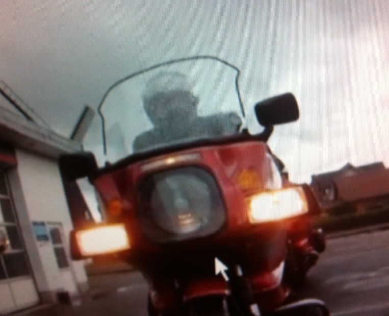

RT lights like this would be a bonus I reckon!
