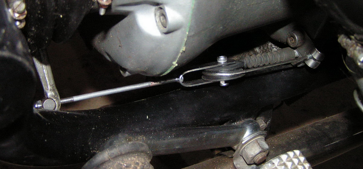

The clutches on the pre-81 bikes are pretty brutal too. A lot of people are using a pulley setup to halve the effort and increase the engagement zone. Here's mine, made in an afternoon after seeing Rob Frankham's version posted on the BM Bikes forum:
NEWCLUTCH S.jpg (179.94 KiB) Viewed 6391 times
I can squeeze the clutch lever between thumb and forefinger (I had already installed the lighter clutch diaphragm spring). Makes me grin every time I use it. If you don't have the means or inclination to make one there's a bloke over on ADVrider selling them for US$80 (ouch).

jackonz was concerned about the reach to the lever. The EZClutch system you show reduces the forces, but doesn't address the reach issue.

Yes Kurt, Phil’s request was pretty clear but he is an old fart like me and probably has hands that have been over used and abused like mine, so I thought it worthwhile to mention my solution. Lessening the effort required to pull in those levers and shifting the engagement points so they are closer to the bars has made riding a far more pleasant experience for me. Safer too, since I can actually stop forward motion without too much praying.
FWIW, I also threw dollars at a whole new throttle perch, new cables and lighter carb springs. The old bike feels younger and more lively, so more grins for me.
