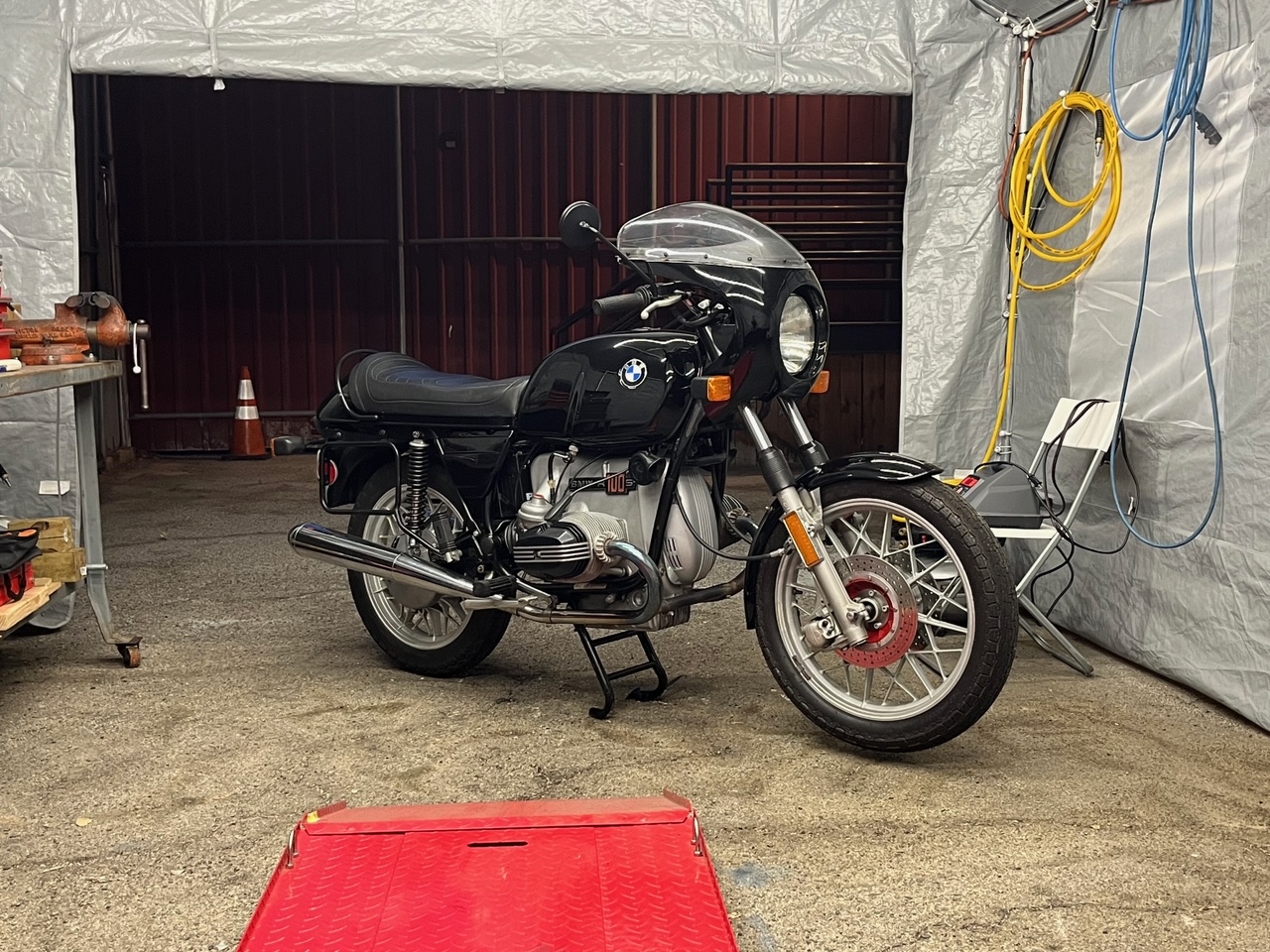

Hi folks
1st post … some photos attached below
Background about this motorcycle:
1978 BMW R100S
Matching numbers
Factory production date 12/1977 According to info found online
Odometer approx 15,000 miles believed to be true
Purchase: 11/2023 locally (Los Angeles) from second owner. (No service documentation supplied). Seller says he purchased from original owner In SoCal in 2021 or so.
Appears to be true low miles bike (15k)
Appears to be factory/stock mechanically except:
Boyer Bransden electronic ignition system installed by a previous owner probably decades ago (BMW - Type MK 3)
I have not touched/adjusted carbs since acquisition…seller said he went to local airhead ‘guru’ for carb adjustments…
Current status:
Runs pretty well
throttle feels subpar
idles ok but only after completely warmed up (1300-1400 at idle according to tach)…yes it’s probably too high.
Handling is good so far…under 60 mph only.
So, I’m about to start the following work and have all parts/materials ready to go:
-not in any particular order-
Check/adjust timing
Check/adjust valve clearances and rocker arm end play
Check for air leaks all around carbs (spray brake cleaner test)
Install new (correct??) spark plugs- BOSCH W5DC (currently NGK BP6ES)
Install new (stock BMW) plug wires
Service/lube throttle control
Install new (stock BMW) throttle cables
Install new (stock BMW) choke cables, service choke lever (airbox mounted)
Disassemble/complete rebuild Bing 40 carbs (all parts from BMW)
Synchronizing carbs
So here’s my problem/question:
Seeking advice as to the best sequence of the above tasks.
My main concern is making sure I have a decently running bike to take those required 5-10 mile warm-up runs prior to some of the tasks. (Will be first time working on Bing carbs)
Have been studying/following Snowbum’s writings diligently (Thank you Snowbum!!)
And also William’s videos from Boxer2valve (Thanks William!!)

The very first thing should be a compression test to establish what you're working with.

Re: Semi-restoring a 1978; Need advice about best sequence? (long)
Congrats...the bike looks sensational.
15Kmiles does lead to a
Do you have a history with airheads? In case you're new to the foibles here's a couple of bits o'info...apologies otherwise.
Check/adjust timing... remove the battery neg from the battery to avoid a short on the diode board as you remove the front cover. I tend to leave the connection at the trans end alone because the thread in there isn't strong.
Check/adjust valve clearances and rocker arm end play. If you do the stud retorque, many will back away from the final torque...eg 2-3ft/lb less than the book numbers to avoid pulling a stud. It happens.
Check for air leaks all around carbs (spray brake cleaner test) intake spigots can be loose too. Less than obvious reason for a high idle.
Install new (correct??) spark plugs- BOSCH W5DC (currently NGK BP6ES) The NGK are just fine. The Bosch were getting hard to get.
Install new (stock BMW) plug wires and consider plug caps too but later if required.
Disassemble/complete rebuild Bing 40 carbs (all parts from BMW) if it's truly 15Kmiles then the only hard parts to change would be the needles and needle jets. They're prob still ok but if it's all apart and they're cheap...lots of small o-rings otherwise.
Synchronizing carbs... Once tuned, they tend to idle poorly until fully warmed up. They do require a decent warm up ride before doing the carb tune otherwise you'll end up with a high idle.

At this time I’m proceeding with the assumption that it’s a low-miles bike. But time will tell…

I have no airhead history, so it’s all new. I owned a ‘71 Norton Commando 25 years ago. Most of my wrenching was on a 1969 BMW 2002 and a 1973 BMW 2002tii. Also quite a while ago.
I’m finding the airhead is fairly easy to work on but at the same time complex due to lots of idiosyncrasies and differences between models/years. The usual resources are lacking and can’t really be trusted it seems (clymer and Haynes). Luckily there’s Snowbum and William (Boxer2valve)!! And Brooks.
Most importantly the availability of parts is fantastic (way beyond my expectations).
Also thanks for taking time to pass along the tips in your reply.
Pleasure. You'll find some excellent advice here and you'll learn to know who has the clues. I'm not necessarily in that echelon but incorrect advice is corrected soon enough.
If you're a wiz with carbs then this is probably too much info. However it does present from the point of view of a carb "newbie" (me at the time) and might be useful. Hopefully so.
http://rossmz.blogspot.com/2008/12/tuni ... r-bmw.html
