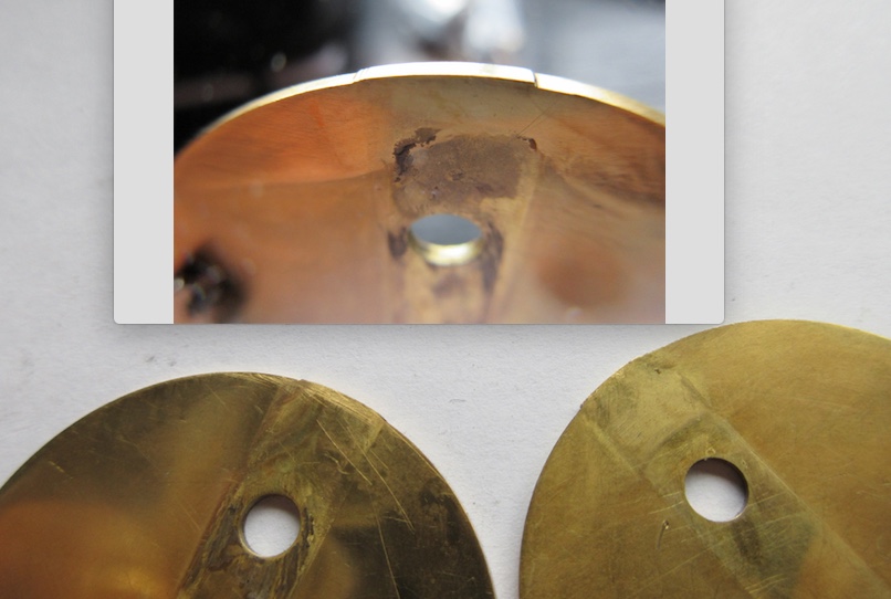

Other things to check include the condition and positioning of the actual butterfly, I've seen quite a few that were installed with the taper the wrong way during a previous rebuild. With the throttle stop screw backed out, there should be virtually no light showing around the butterfly when you hold the carb up to the light. The pics below are of worn butterflies (they should be perfectly round) that hindered precise idle mixture adjustment and caused some popping on decel even though the bike seemed to generally run OK.
- Untitled.jpeg (101.62 KiB) Viewed 2293 times
