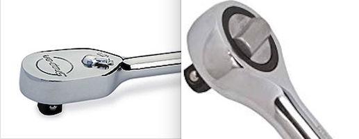

The ratchet type I was referring to is on the left. It's much thinner and has a small lever to change directions instead of the cumbersome knob to turn (like the one on the right). This 'lever' type is a lot thinner, and its direction can easily be changed one-handed with the flick of a thumb when being used deep down in a cluttered engine compartment or up in a tight under dash space.

Yeah, I was looking for something like that, but came across a small socket set that fit. It got the job done. Thanks again.
