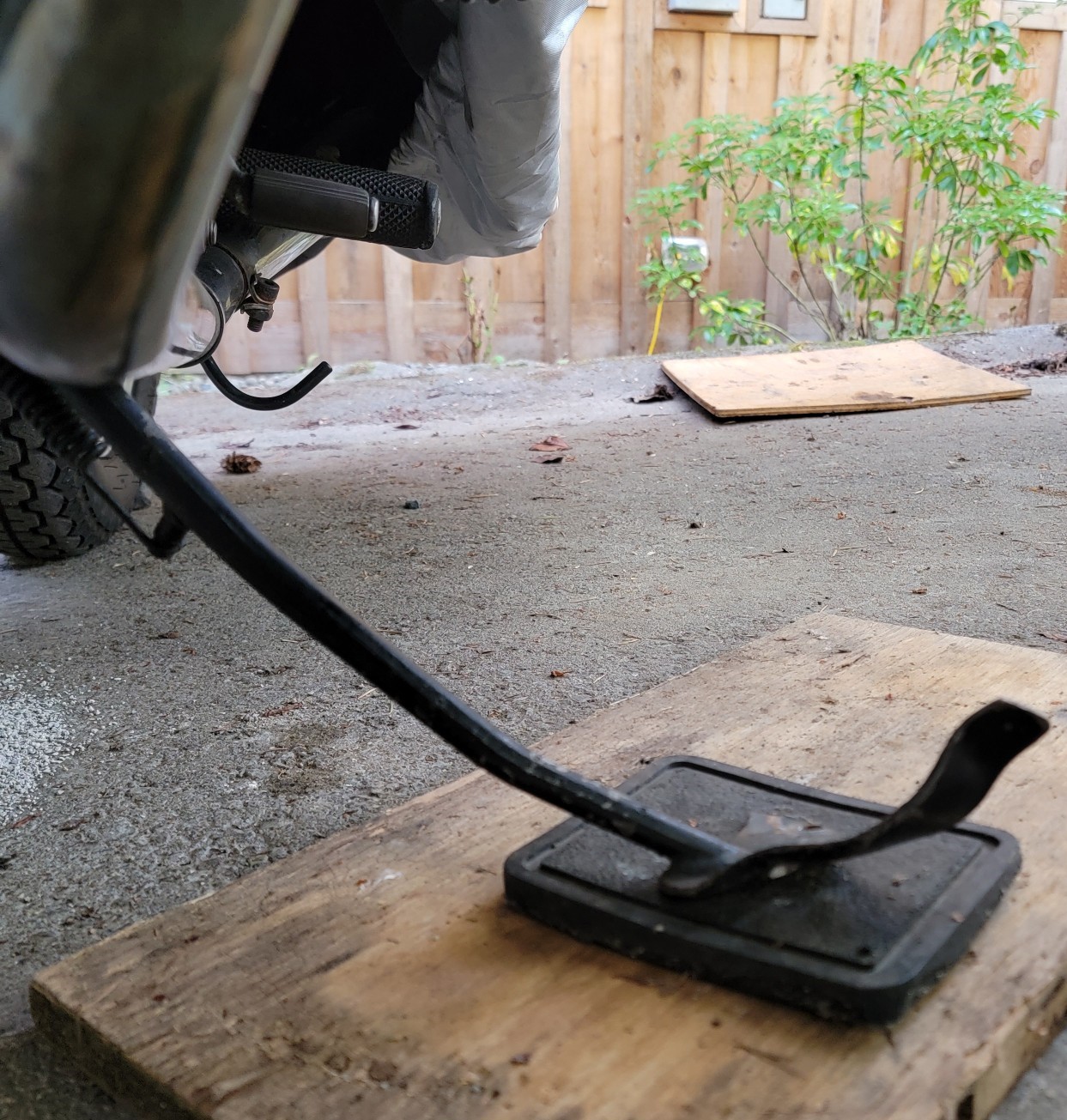

It leans too far over. The PO had fixed a bolt/plate contraption on to the heal but I kept getting my pants hung up on it. It may be the wrong stand or perhaps bent a bit but it does appear to close up nicely.

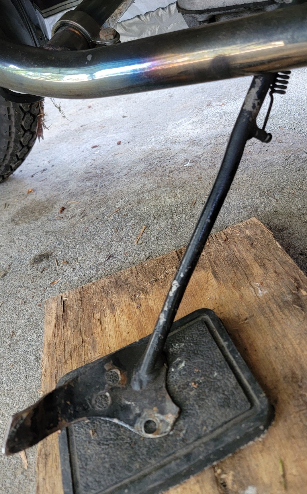

You OEM stand is probably the same as all from /5 thru /7. If it leans too far, then it must have been abused and bent the attachment/pivot point. Any pictures of the situation?

Kurt in S.A. wrote: Mon Sep 16, 2024 9:35 am You OEM stand is probably the same as all from /5 thru /7. If it leans too far, then it must have been abused and bent the attachment/pivot point. Any pictures of the situation?
Good idea Kurt. The second picture shows a bend near the foot. Not sure if this is the way it should be. I may have another in my collection of bits but need to go through our storage unit to find it. Oh joy.
Kevin
Re: Side stand extender recommendation for /5
Interesting bend...I'm sure if it were straight, the bike would sit better. Probably a little bit of bend results in quite a bit of lift to the bike.
