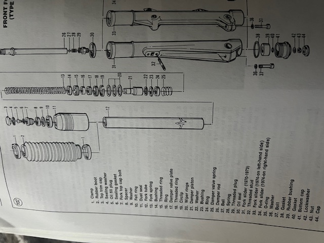

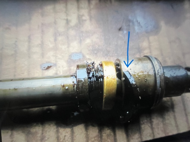

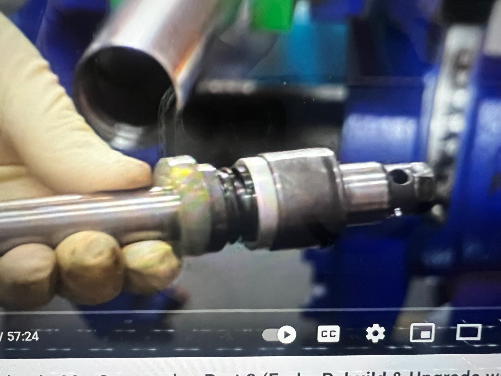

watched a few Ytube vids then stripped my forks and my fork has an rubber washer very strange.
picture one vid off Ytube
picture 2 my fork tube with (broken) rubber washer
IMG_6599 (2).jpg (84.24 KiB) Viewed 1709 times
Picture 3 exploded view from the book not #22 washer
should i have the rubber wash in or not?

got it now
of a parts web site
This is fitted below the 'guide support' at the top of the fork damper unit (the 'guide support' is the fork damper piston which takes the piston rings SUA32059).
Please note; this item does not fit R45 or R65 models.
