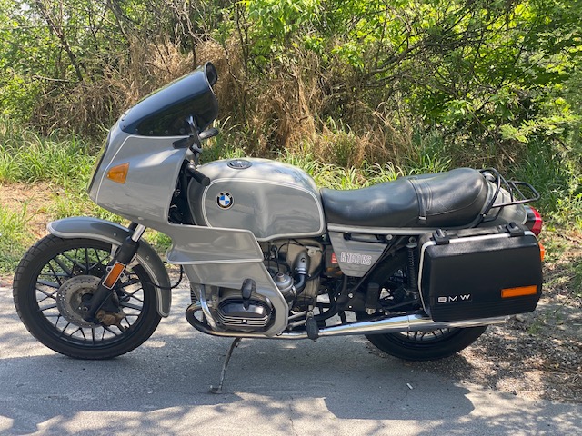

did my first to me oil chage, the motorcycle has an oil cooler, so filter cover is more complicated than a bike with no oil cooler.
I have other bikes, a 1200 gs, ktms, suzuki, honda, and oil hanges on those are 15-30 mins, on the R100RS was 5 hours, had to take off fairing, move exhaust, remove crash bars, so it was very hard and time consuming, especially the crash bars,
OMG that was a challenge, but putting them back was impossible for me, couldnt install the brackets correctly, thinking about removing them, etc
5 hours for an oil change was surprising!! looked youtube on this matter, but couldnt find one tutorial with bikes with oil cooler, crash bar etc, any tips?
thks in advance

mi problem was removing the filter cover, there was no space to remove it, the only way was removing crash bars, and then the exhaust was also in the way, so had to loosen all the exhaust hardware to move it, very time consuming
getting the filter out was very easy, also a one piece filter

Does your lower fairing have the split in the bottom? That allows you to move that easier if you want.

thks for your insights, yes mi lower fairing is split, its easier to get it out, but the damn crash bars, they are ultra hard to get off, and impossible to put them on again correctly
