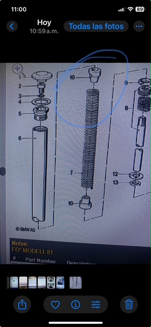

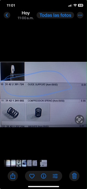

1979 r100rs, theres is a clunk on the front end when hitting a bump or pothole, like steering stem is loose, I adjusted steering head nut, it was ok, so doing a push with front brake engaged everything feels ok, so I did a fork oil change, but no change, I dont know if its something inside the forks, as I was doing the fork oil change, the top cap was directly on the springs, seeing diagrams there is a plastic guide that mine doesnt have, Max BMW diagram say the guides are from 09/80, , mine is a 79, so dont know if those guides are necessary

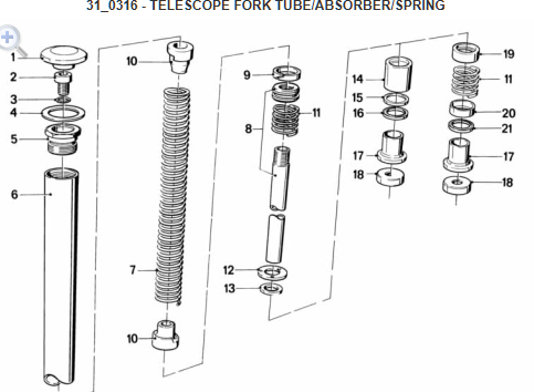

One possibility for fork noise is from the damper valve body. I can't see from the picture you added which design of forks you have but if it's like the one shown below then you can see from the diagram that BMW did a modification to the damper valve body. They moved from the longer solid valve body #14 which could rattle to a shorter sprung valve body #19.
No guarantees that it's the cause of your clunk or that it will cure it but that change was made due to customer complaints of fork noise.
